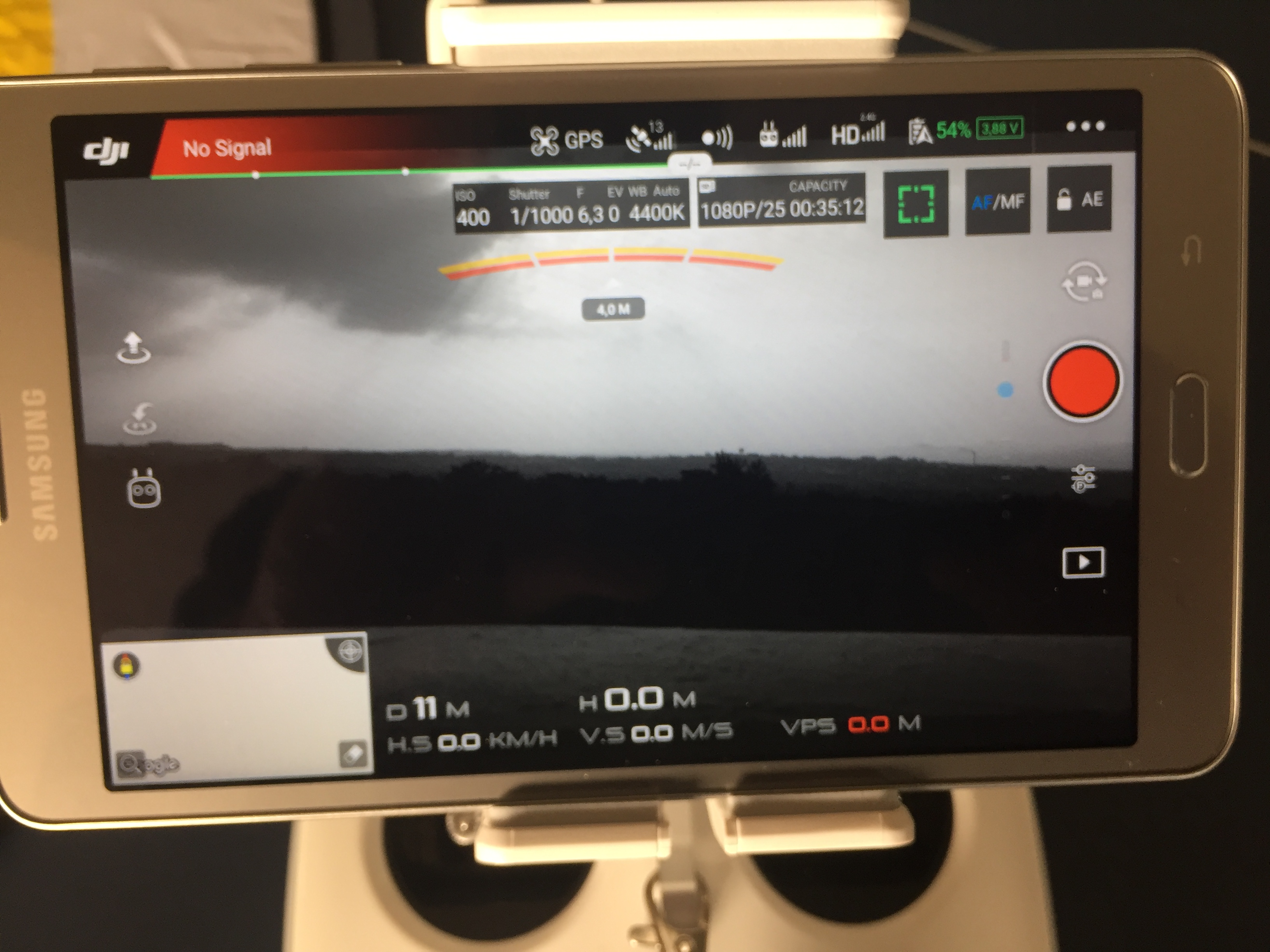

Hi guys.I am having a problem with my new P4Pro.When is start everything up it telss me on the tablet ( Gimble overload ) and when i toggle the camera up and down it does so but there is no live feed from the camera to the tablet and on the top left it shows NO SIGNAL.Pleasec see photo attached and shed some light on this for me please.
Kind Regardsa
Ok guys so we found the problem.Small rubber gromet holding the gimbal that was not remved.All ok now.
