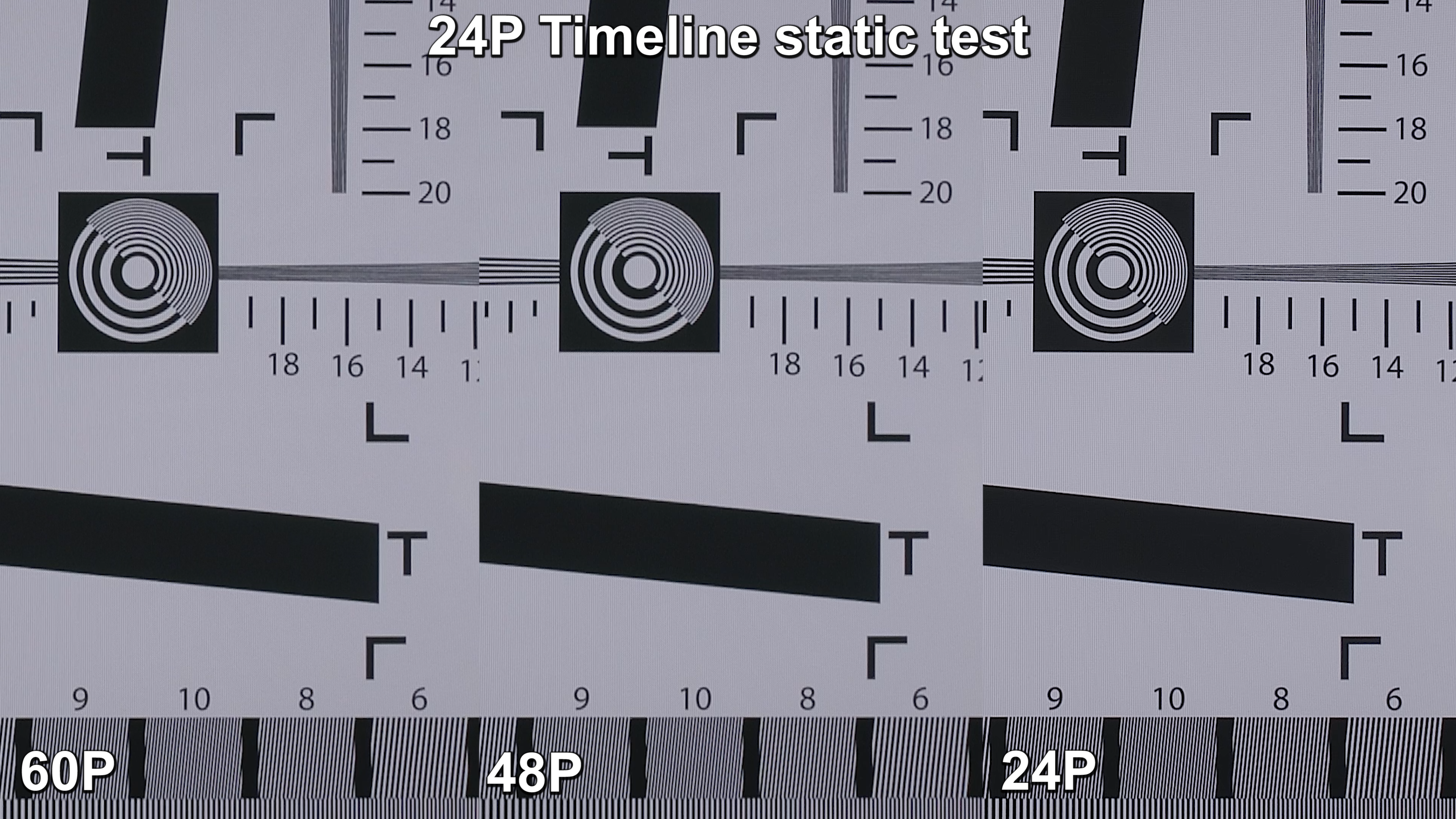

I've determined in testing that there's line skipping occurring with any framerates above 30, which affects horizontal resolving power, which explains why i'm seeing a odd variation of things that look good and no so good. it also seems that the higher framerate codec loses detail in the shadows and lower contrast areas more quickly.
Around the web i see some good looking 60p shots, but as well some that look lacking, like i'm experiencing. The primary question is whether the v2.0 uses line skipping as well, or has a differently tuned encoder.
Compare the lines above number 14
