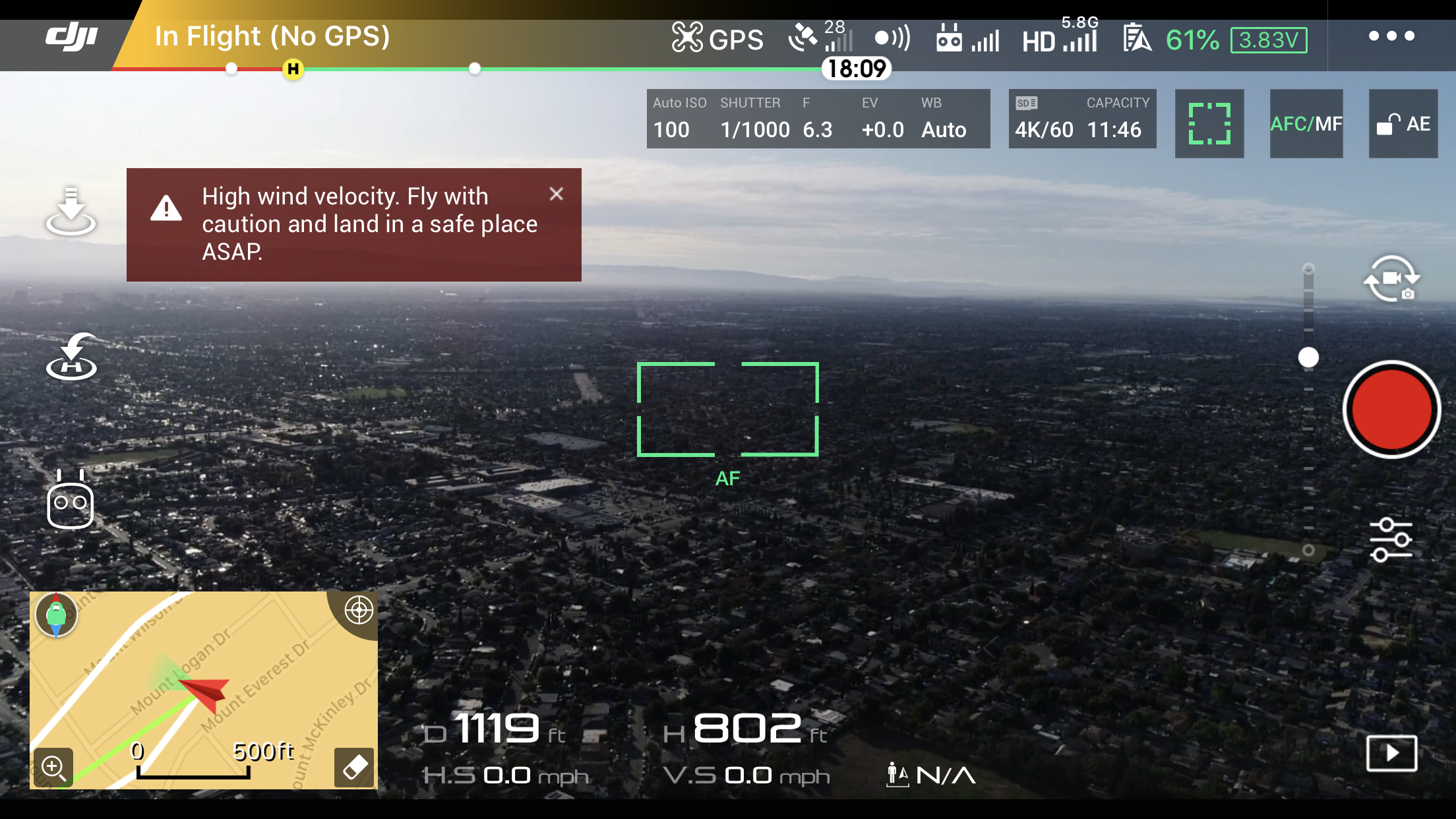

I’ve attached a pic just for the fun of it. Notice the solid 28 satellites. Flying in gps mode and bam, no gps. No comments on my altitude please. I know, shame on me. Anyway, Super Patcher 2.0 is a god send to most but to a handful of P4P guys (including me), it’s a game ender. No idea why but the developer did suspect DJI May have used different gps modules for some birds. I can see how that could be possible....
Interesting. Though this makes me also suspicious.. it the GPS (GNSS if we use proper naming) chip able to report position with the same speed when having so many satellites? Usually by having more satellites you improve accuracy, but also increase the time required to process everything. Not to mention different standards mean additional processing.
