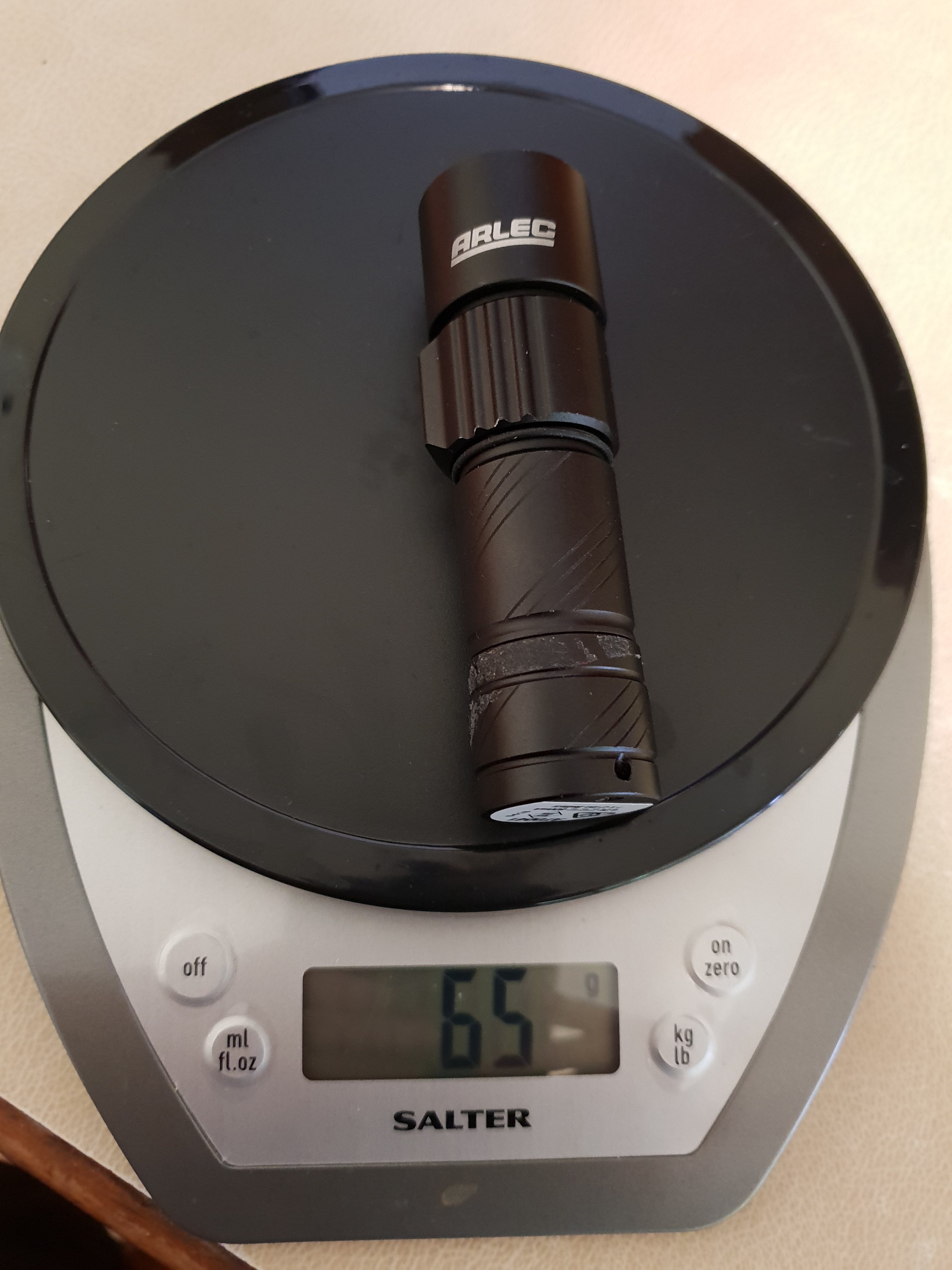

Found out what the problem is. I was carrying a light payload. A 65 gram torch. With the torch attached the aircraft slowed to 12 km intermittently. It would fly slow then normal. This also happens when I was descending sometimes not moving at all. I had to switch to speed mode to override the slowing down.
I would like to know if other P4P V2 owners have similar problems carrying small payloads. I have used this excellent torch many times before with the P4P v2 before and Mavic Pro without problems.

Removing the torch and the P4P returns to its faultless flight. arlec AT0041  200 lm.jpg

Your a clever man With The Birds I have used torches many times on my P4P but this time I attached it on the inside of the aircraft's leg. The downward sensors detected it and figured it was landing and slowed down to 12 km an hour. It was a few hundred meters away and I could have lost the bird. Going into Sports mode saved me. So always consider where the sensors are if you carry a payload and always test it near you.
