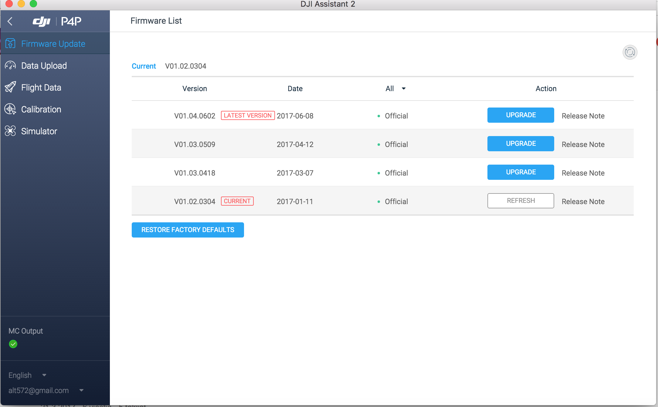

Here is what I saw when I connected to DJI Assistant 2 on my laptop
Currently updating to latest firmware. Wish me luck
