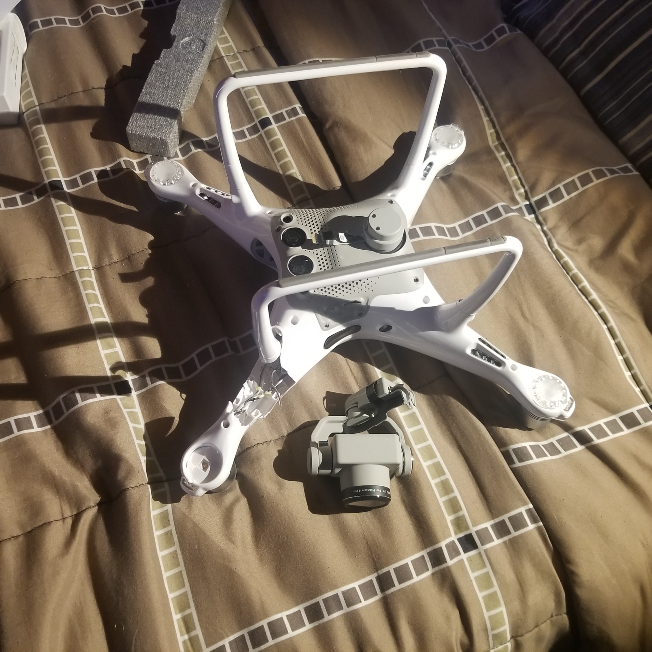

After 2 months and not believing these just fall from the sky my P4P did just that. Been trying to connect my PC to it but nothing, drone just beeps and the battery has light 1 blinking with 2&3 solid. Any quidance would be greatly appreciated.
Thanks SAR,. Took a look and it's completely my fault. I somehow managed to shut the motors down at 121 foot.
Guess I'll pray DJi Refesh handles it.
Appreciate everyone's help.

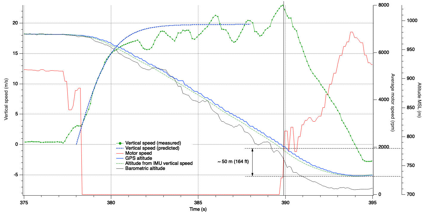

I did get to look at one set of data for this maneuver with a Mavic:
The Terminal Velocity of a Falling Mavic 2
After terminal velocity was reached it required about 50 meters to restart and arrest the descent:
