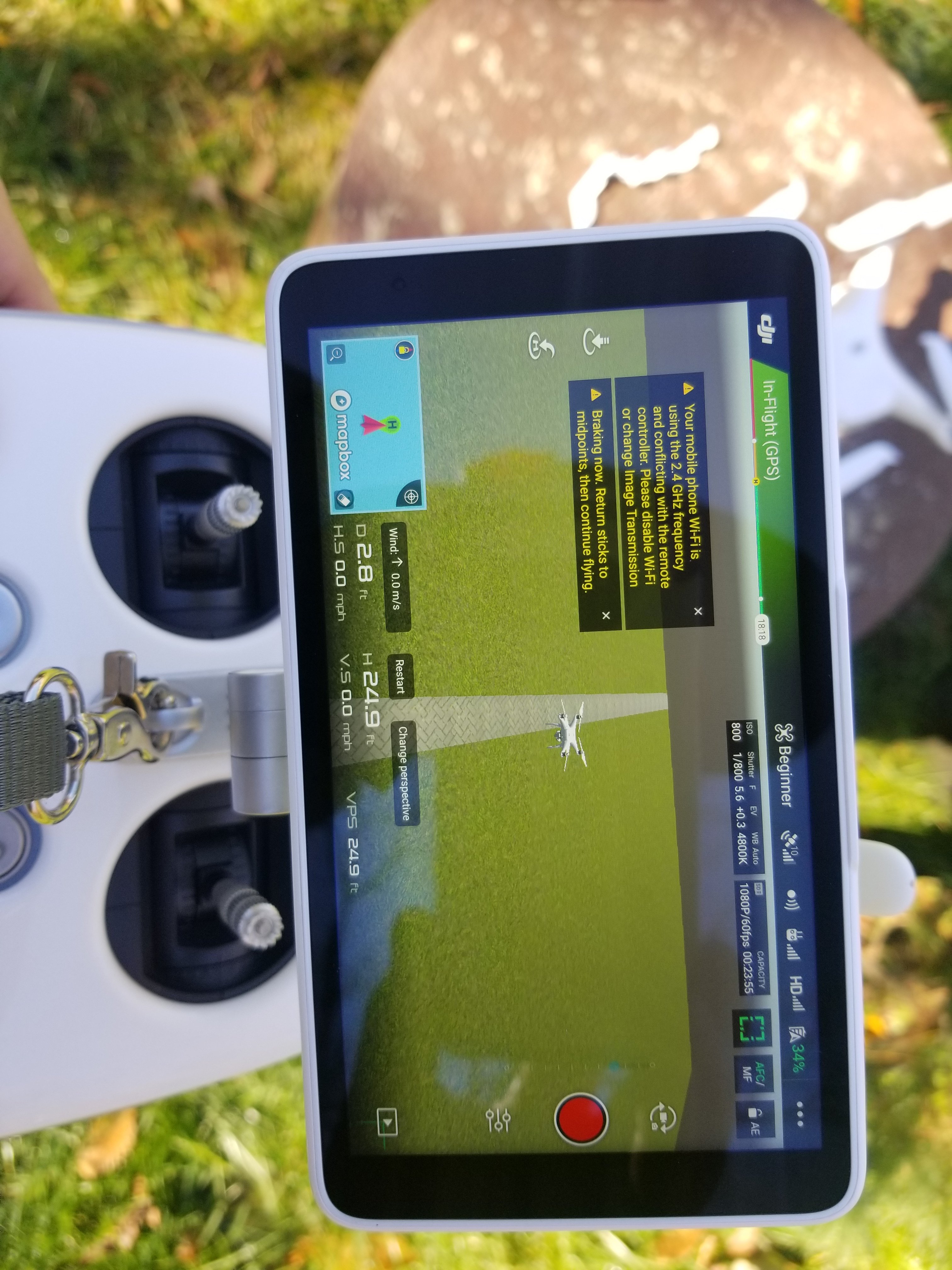

Finally, the last thing I did was go into flight simulator and I keep getting messages while flying that say "Braking now, return sticks to midpoints, then continue flying". However at this point I'm not even using the controls. So I was wondering if I have an issue with the control sticks. And when I tried calibrating the joysticks when left alone untouched they both read 0% in the middle and both go all the way to 100% in all directions leading me to believe they are fine.

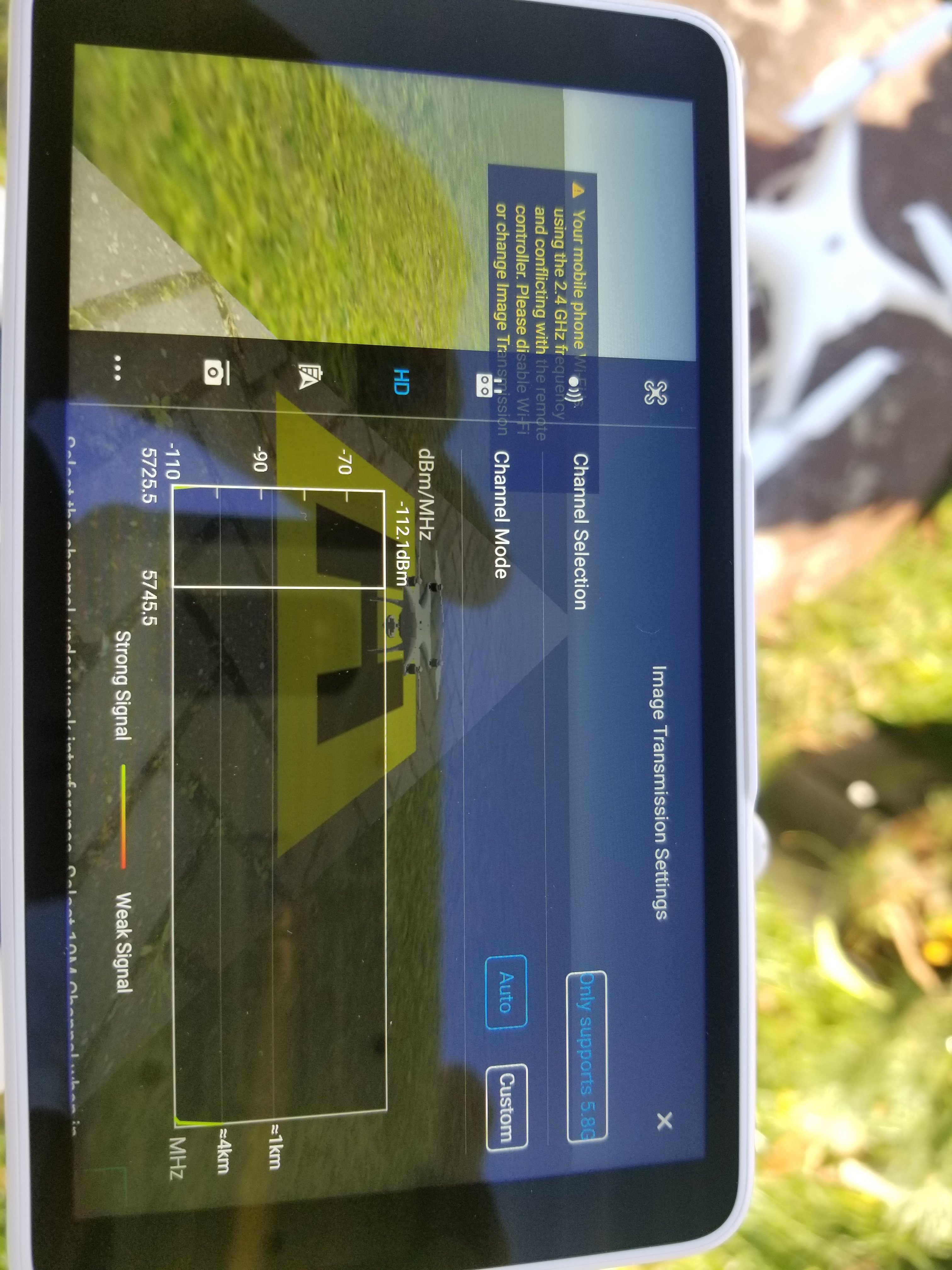

I uploaded an imagine of my channel options when trying to change imagine transmission. Essentially its not showing anything besides a tiny bit of green at the bottom.
Finally, I took a pic of my controller screen when in simulation. You can see I'm getting error messages prepare to brake when my hands are off the control sticks. I dont know if this is a clue that its reading movement from the controls when I'm not even touching them or what. But in the flight simulator I'm not experiencing the drifting upward altitude like I do with the drone itself.

Any idea why i'm not seeing anything on the image transmission channel options when I choose 5.8 GHz?
