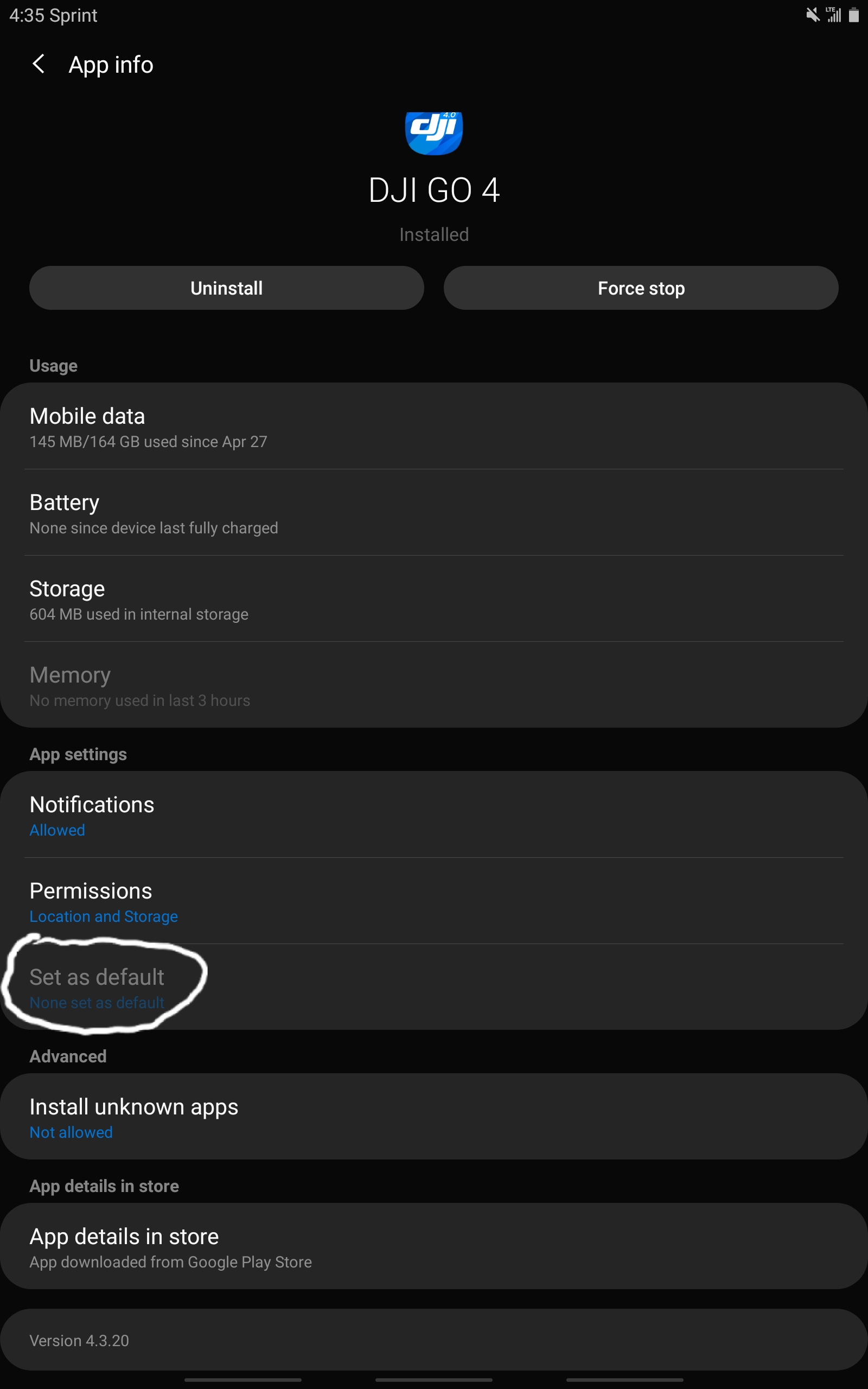

Go to Settings>Apps and look for all of the apps related to your drone. In the option of Default, make sure to hit clear or reset as to force your phone/tablet to give you a menu with the various apps you can choose to fly when you connect it to your controller. Just make sure to chose "Just once" every time or if you plan to fly only with DJI Go, choose that one permanently.
Done that, no change. The DJI Go 4 app will not connect when I start it up, and the Kittyhawk app will connect.
