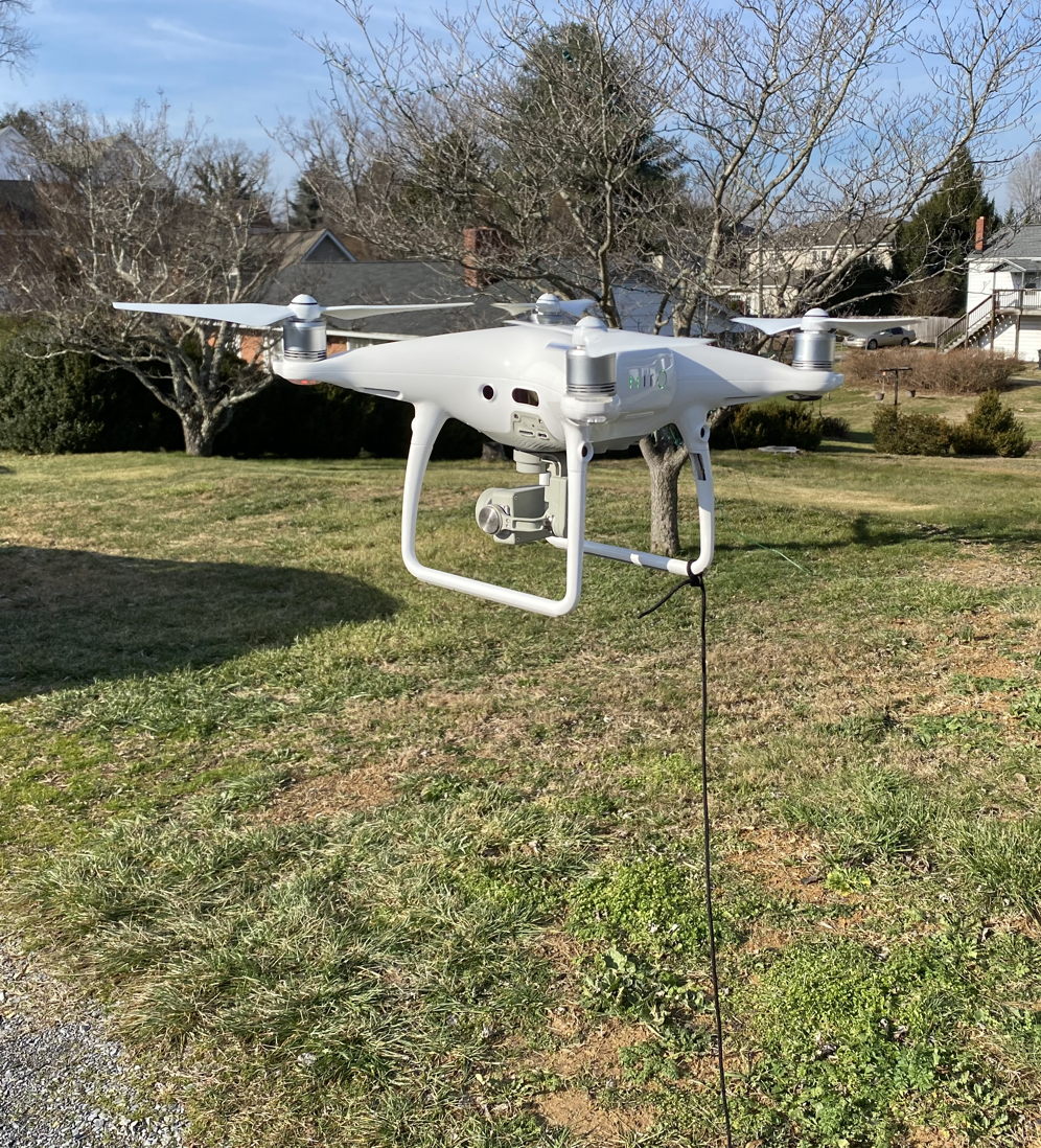

We finally got some decent weather today. So I did another test. I set the P4 on the ground away from anything metal. As shown in the attached photo, I used a tether in case it decided to fly off again. This time, it behaved like my drones have behaved in hundreds of previous flights. No idea what caused the problem and hope it won't happen again. One valuable lesson came out of the incident. I sometimes launch the drone from a ship or boat. I realize this can be risky due to metal on deck, but it's something that I need to do at times. As a precaution in the future, I will attach a tether at startup when on the water. Unlike in the attached photo, I will rig the tether so that it can be released from the ground.

Well that's a good one,you need to get trust back,,,good idea to prevent flyaway but also risky ,,are you doing auto take off or manual, myself would check imu and compass is ok,yip stick calibration to make sure stick inputs are corect

My main concern about a possible flyaway is to avoid damaging someone's property, causing an accident, etc. I Idid a manual start, but it's relatively strong line that wouldn't be likely to get caught up in the props. I intend to run all of the checks for sure. Thanks for the inputs!
Now this flyaway thought is on all pilots minds and it happen to anyone,anytime,anyplace,,fortunately we can do checks and precautions to help avoid this but dont matter how much precautions we take it can happen for some dumb reason,,agree on property damage, I had p4 free fall onto my own house roof after battery error shut down in flight and smashed the concrete tiles on roof,again lucky it was mine because when happen I was trying to get back overhead ,I cant afford fix someone's stuff so I avoid flying around like I used to,,,I also use me drone for fishing and I carry braided line out and dont matter if strong string or line if something does occur the drone will tilt and tangle alright,,I been close and lucky at times,I just mention auto take off cause it will rise to height and stop so make enough line to allow for that,,as mention above try flight with go and if abnormal its easier to read what's happening in the data,,,do your checks,give it some tests,blow those cobwebs outside and best of flights
