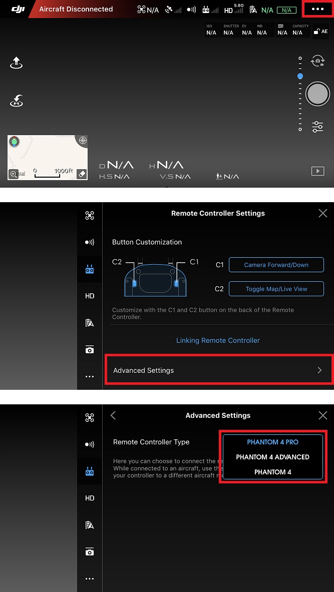

It will pair with the P4 if you set the "Remote Controller Type" to "Phantom 4" before attempting to pair it.
