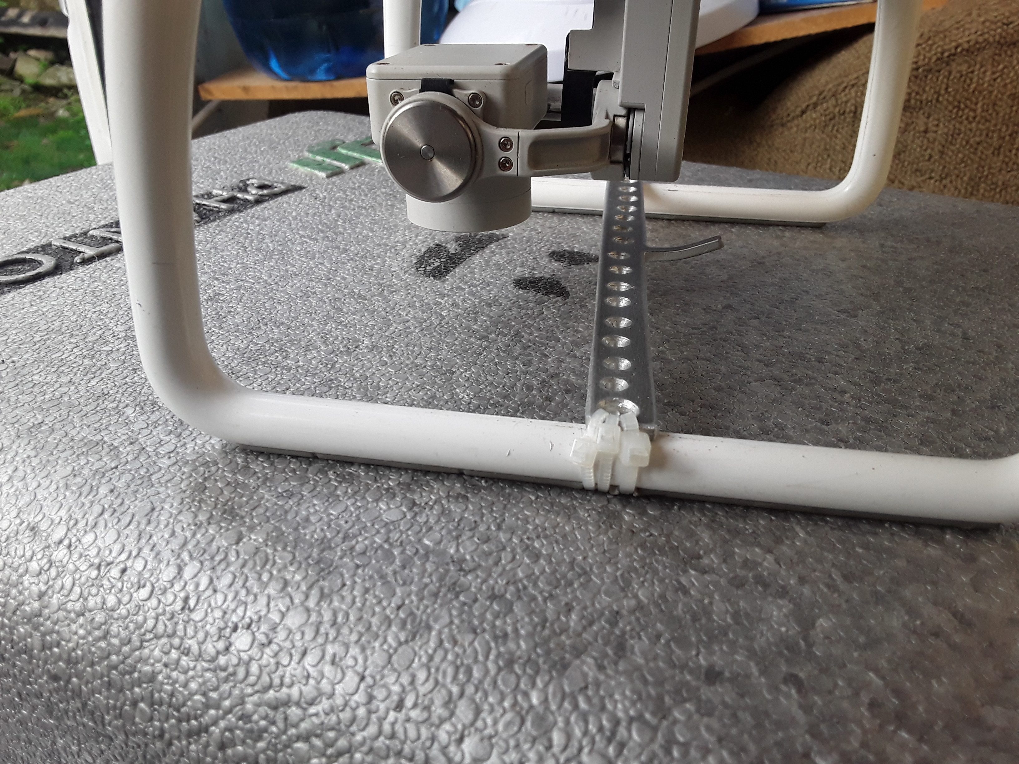

I just use home made contraptions for my p4,but will work on any drone,,can carry 6 once sinker and 3 baited hooks,this is safe amount before motors start really working hard,,swivel just sits on tab you can see and either stopping and till back or tightening drag on surfcaster will make it drop off the back,easy,,as for buying stuff you might be in for a wait mayby,,I'm still waiting for Ebay orders but everything is stopped at customs during this lockdown issue so we been advised not to shop ..online..ps..I do all my drops in sport mode so it's got the power,,it dont like GPS mode with weight.gezz we not even allowed to go fishing in this time ,,surfcasting or with a boat

Hi ianzon, that homemade contraption looks great. Centered enough to balance and carry payload without interfering with camera. Lightweight and strong enough to carry a good load. Does the load come off easy?
Yes works good,either tilt back and slides off or drag on fishing reel and comes off while still moving forward
