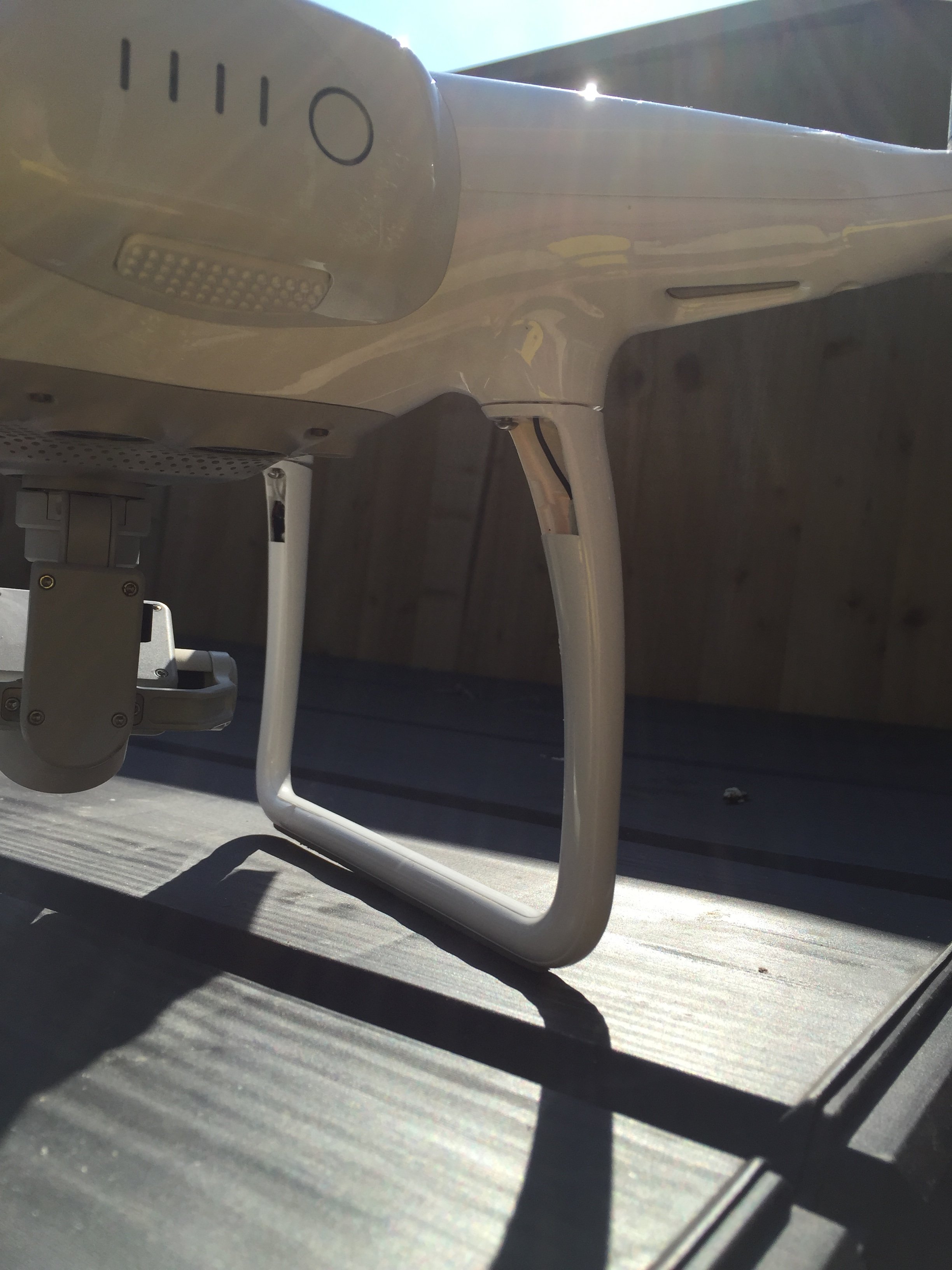

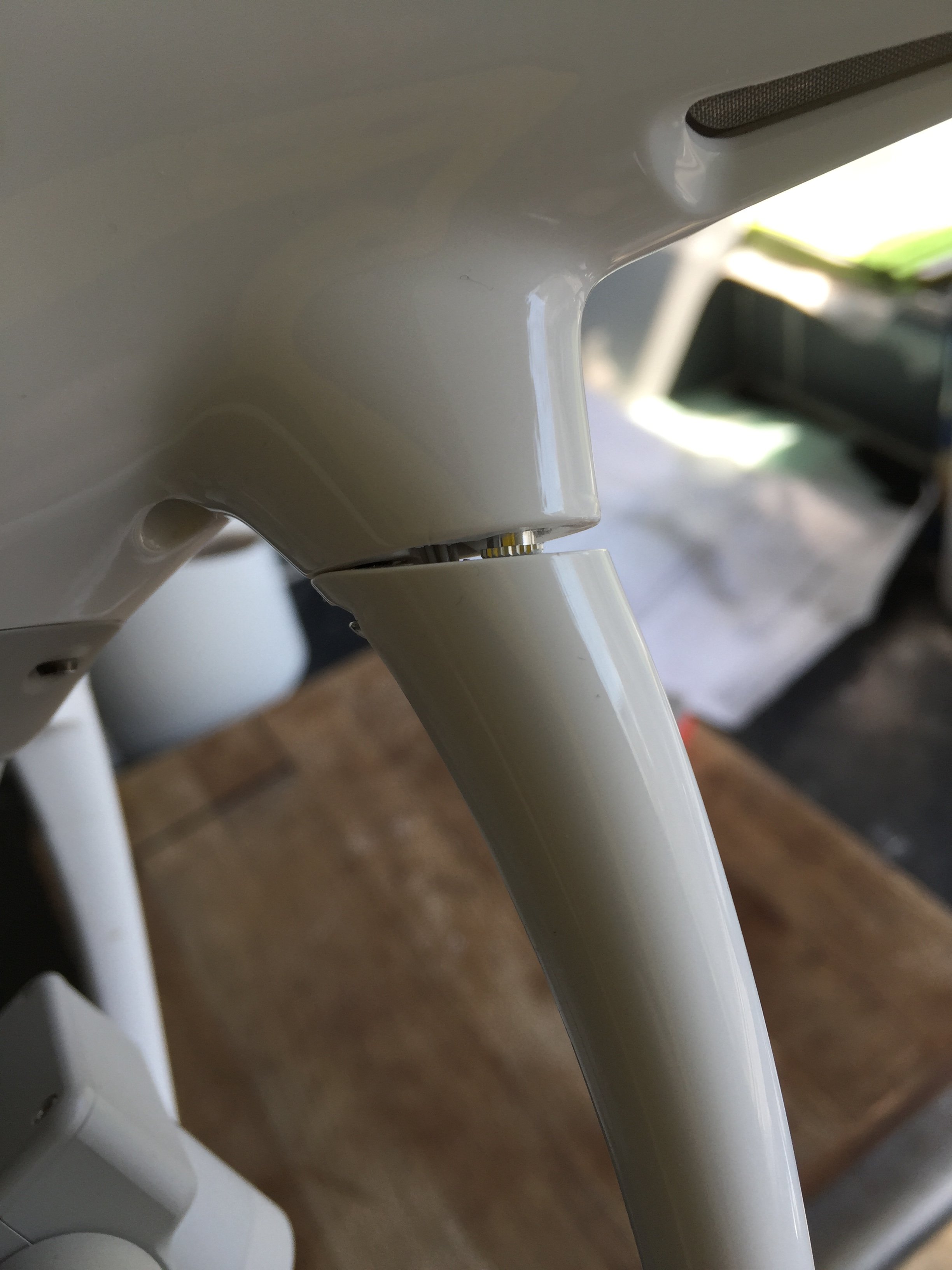

Had slight damage landing now see attached
constant bleep with no connection and red flashing led light near SD slot.

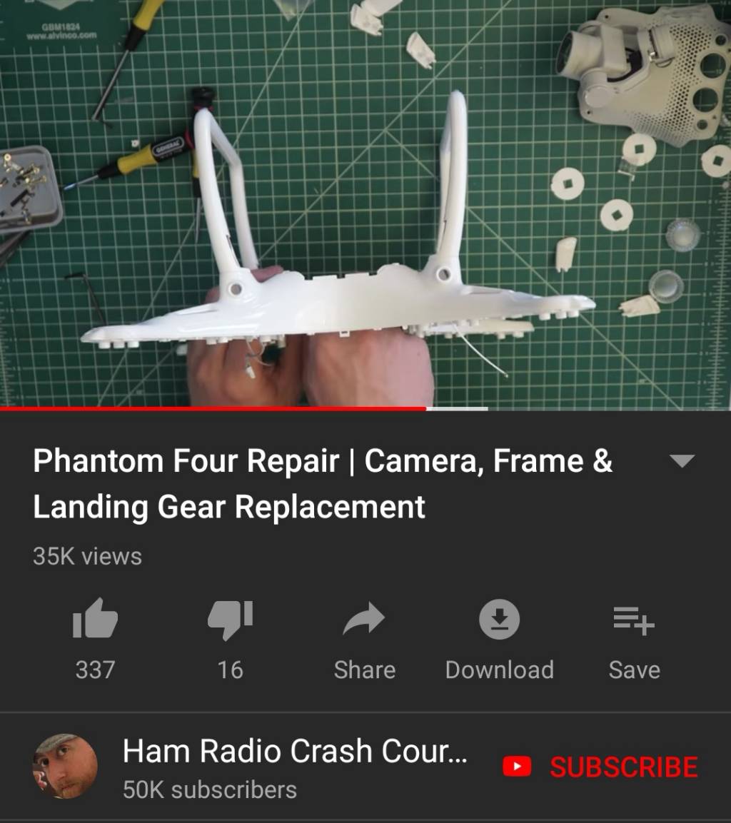

There is a video I found on P4 Landing gear replacement that may allow you to fix this issue. I'd assume that something has come loose within the landing gear as there is a small type of "logic" board near the top of the landing gear which becomes loose fairly easily. Anyhow the video is in the image below.

That little IC board in the leg is the compass. They put it out there to get it away from the mass of metals and electronics inside the shell. That brass object showing in the first picture between the body shell and the landing leg is a pressed in insert in the leg. It has been pulled out of place by force applied to the leg in a hard landing. You need to replace the landing legs. There could be other damage inside the shell, such as to the gimbal mount to the anti-vibration plate.

Thanks for that, we saw YouTube vid explaining how to take apart most comprehensive.
It mentioned what you said in graphic detail?
We have purchased p4 bottom en legs and will take existing apart and replace ?
