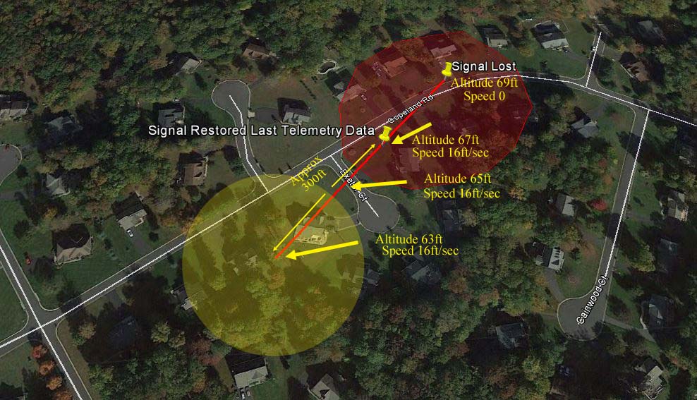

At this point I would not expect anything from DJI. I may not have a chance this evening to look farther but before you go scouring the forest, look at the last known GPS location on Google Earth. Since the aircraft was descending straight down with no forward motion at that point, you may get an exact location.

Thanks for the tip. I did just that. I knocked on a few doors, and looked through the bushes around the 2 final GPS locations (even though they were both at 65+ feet). It's that weird final blip (after 13 seconds of nothing) a couple hundred feet SW that inclines me to hit the woods. In my search, I did come across a neighbor that has a P3, and he is willing to help me scout the tree tops. Whether we find it or not - I owe him!
When you lost Signal, the bird was coming straight down. Speed was at 0. The last signal you had and what was odd that it stopped right there, was at 67feet and 11mph, which is 16ft per second, roughly. I think and I only think this because judging from that last data point, and assuming a GPS accuracy of 50 ft. I think you hit the side of that house at the last telemetry point. There is nothing else there that is that high. And it instantly stopped transmitting. That's just a WAG. I could be wrong of coarse. Just really don't understand why the data stream stopped immediately upon signal restoration, other than an instantaneous impact.
That's a good point about the GPS accuracy. I was taking it too literally, and assumed that it must have flown over any houses. I'm going to re-focus my search today in a wider radius around those two points like what you highlighted on the map. Thanks!!

I agree, that area is fairly open, from that map I added the details on I could only assume that from that last transmission and the altitude given that the direction it was travelling had not changed from the final data point. So If it did not strike anything, lets assume it was on the same path and at relatively the same altitude. Im going to do another calculation with those numbers and put up another map. Check back in later, and let me know if you have looked in the area I come up with. My guess is probably, but just let me know.

Ok, after looking at some more numbers, and again this is only a WAG with really only 2 useable data points to go by. One can only go on the assumption that from the point of signal loss until restoration at that last data point for ony 100ms., that the bird continued on the same path, at the same speed and at the same rate of descent from the point of signal loss. Over the distance from signal loss to restoration, the bird only descended approximately 2 feet between those two points. So using that as part of the WAG and the speed indicated of 16ft/sec, this map shows where the bird "should" be within the yellow circle, giving GPS accuarcy and the previous assumptions. Being that it was at 67ft at the last data point ( give or take for Barometer error), I highly suspect it hit something in this area, that is of coarse if all assumptions are accurate. If it remained at that altitude or continued to descend, there is no way it would clear those trees, and possibly that other house in the yellow circle. The red line is just a 300 ft marker for reference. If you do not locate the bird in this area, then either as you mentioned, someone picked it up, or you have a flyway to who knows where. Also, you may want to re-post again with a different thread, and ask for Data Analysis and have another take a look just to double check. If you do, post the flight log along with it. And no problem helping out if I can.

Ok, after looking at some more numbers, and again this is only a WAG with really only 2 useable data points to go by. One can only go on the assumption that from the point of signal loss until restoration at that last data point for ony 100ms., that the bird continued on the same path, at the same speed and at the same rate of descent from the point of signal loss. Over the distance from signal loss to restoration, the bird only descended approximately 2 feet between those two points. So using that as part of the WAG and the speed indicated of 16ft/sec, this map shows where the bird "should" be within the yellow circle, giving GPS accuarcy and the previous assumptions. Being that it was at 67ft at the last data point ( give or take for Barometer error), I highly suspect it hit something in this area, that is of coarse if all assumptions are accurate. If it remained at that altitude or continued to descend, there is no way it would clear those trees, and possibly that other house in the yellow circle. The red line is just a 300 ft marker for reference. If you do not locate the bird in this area, then either as you mentioned, someone picked it up, or you have a flyway to who knows where. Also, you may want to re-post again with a different thread, and ask for Data Analysis and have another take a look just to double check. If you do, post the flight log along with it. And no problem helping out if I can. View attachment 83896
I agree with what you are saying, and have spent a fair bit of time along that red line you proposed. I will expand my search given the margin of error you indicated. Thinking "out loud": Circling back to what you pointed out earlier - if it was still in flight after that last data point, why was I not receiving telemetry any more? That's rhetorical, of course. Just trying to tease out some sort of sequence of events that makes sense.
Not sure if I mentioned this, but P2 on the waypoint path was right along that red line, but closer to the street beyond the trees (again at around 150 feet altitude)
