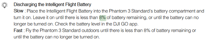

They used to recommend it in the DJI battery safety guidelines. However, it's not listed as a recommendation in the current version of that document. In this older version, it recommends the following:
"Charge and discharge the battery completely once every 20 charge/discharge cycles. Discharge the battery until there is 8% remaining power or until it can no longer be turned on, then recharge it to the maximum capacity. This power cycling procedure will optimize the battery life."
Can I increase battery life after deep discharge ?
DJI seems to think so (or they used to anyhow). As far as I know, all it does it balance out the battery cell levels. If that's the case, then you really should only do it if the battery cells are really out of balance.

How
DJI seems to think so (or they used to anyhow). As far as I know, all it does it balance out the battery cell levels. If that's the case, then you really should only do it if the battery cells are really out of balance.[/QUOT
I am a real newbie but how do you do a deep discharge ?
How do you do a deep discharge?
