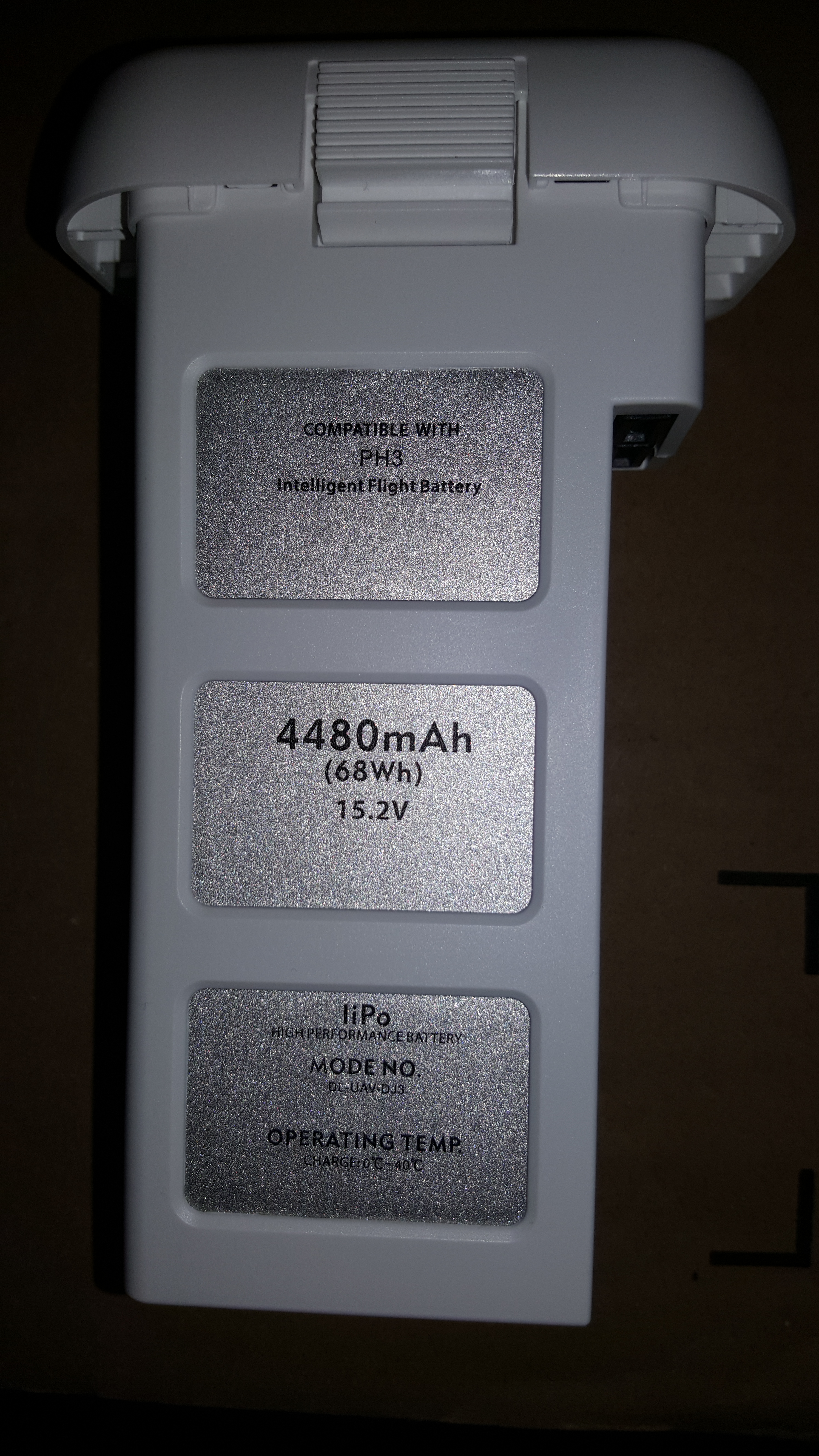

A tell tell sign of the specific battery I received is that it has a bird type foot print instead of the rectangular power indicator bars. I really don't know how else to describe them. Hope that helps. In fact, here's the link of the one I purchased....

I also received a generic battery I bought off amazon that was listed as dji that i have to send back.
Yup that's the exactly what I had
Try to update the FW for us Orion !! Before you send it back .. And screenshot the battery page on DJI go app
