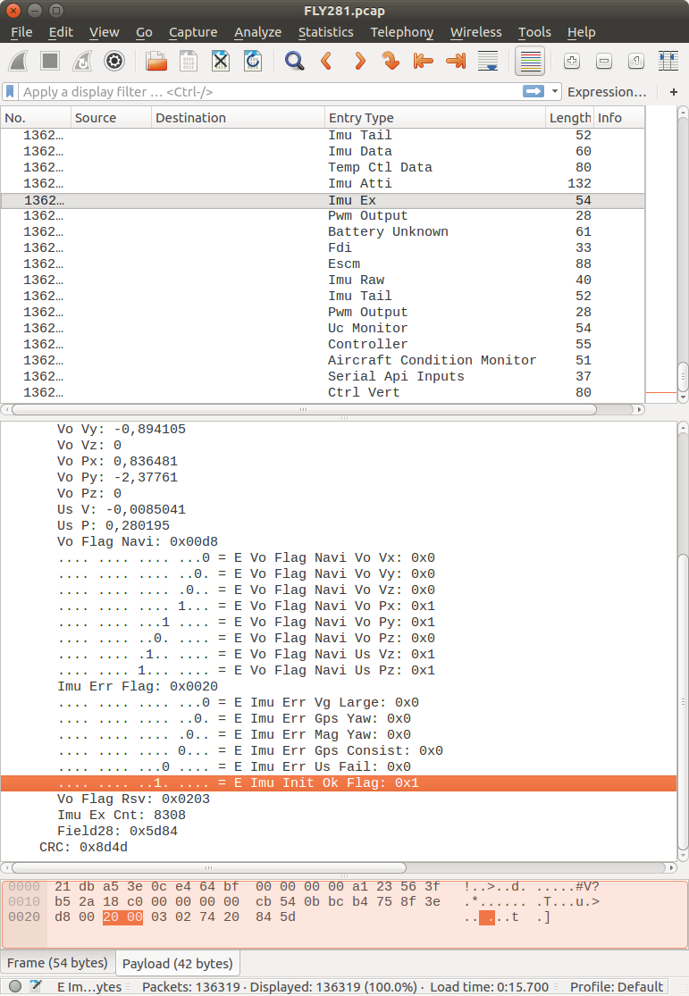

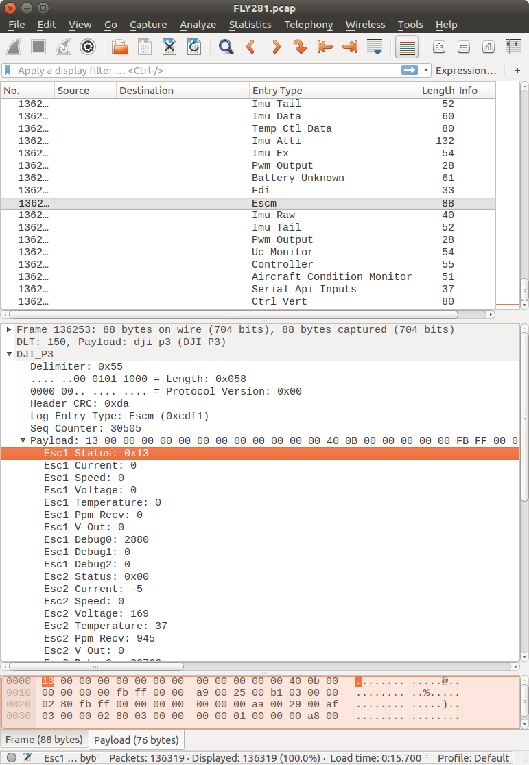

Only the binary log stores enough information to fully diagnose this. From the text log I can only say that all four ESCs are responding to questions from Flight Controller.
CSV can contain different data depending how it's generated. The best one to share is DAT, and that's the binary one.

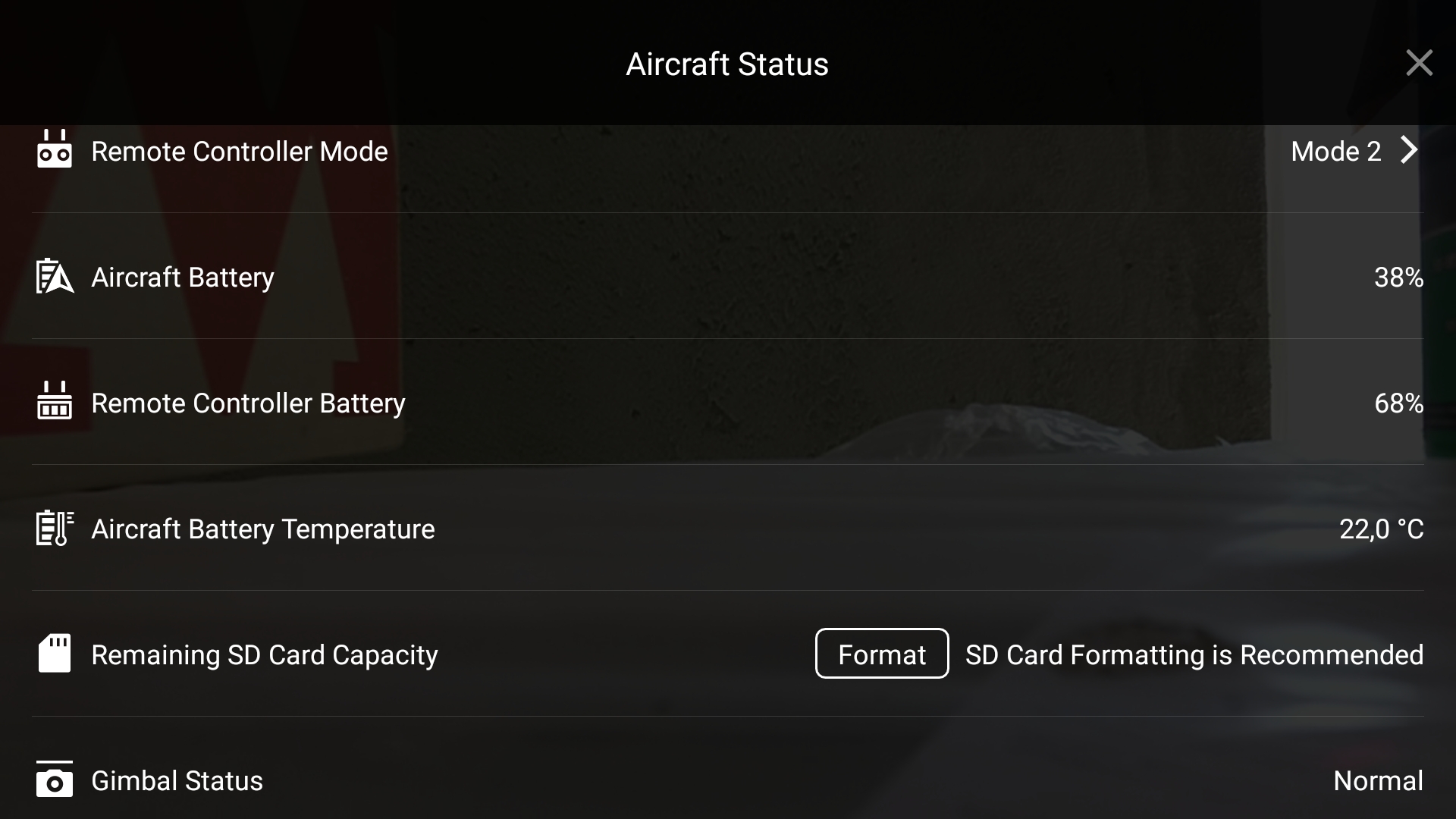

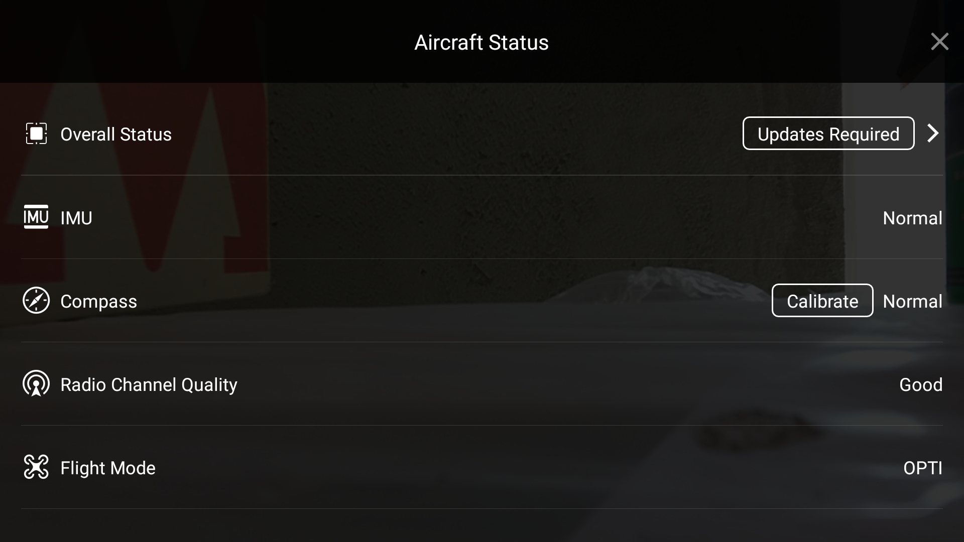

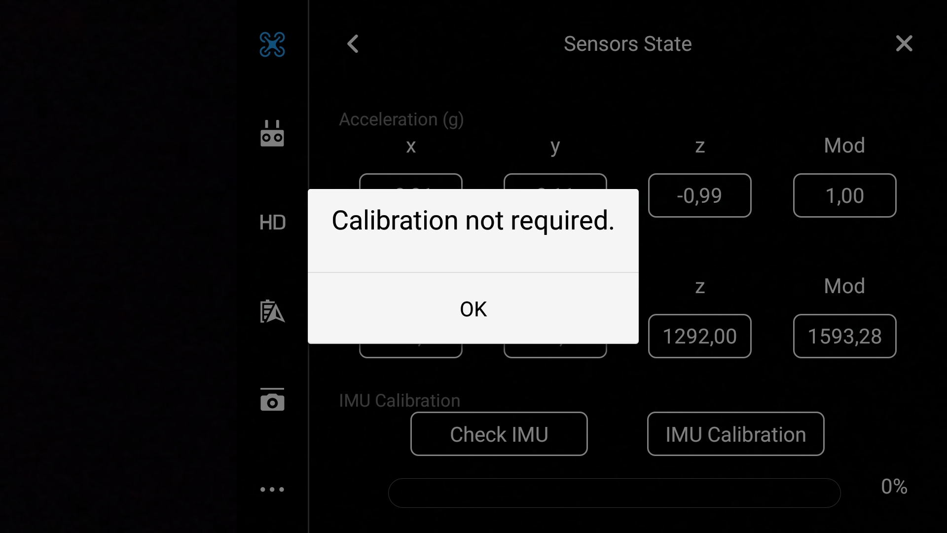

Go App shows this:
It requires only Battery firmware upgrade
What should I do next?

Yeah, there is probably just an ESC issue.
What to do - either the motor or the ESC circuit is damaged.
- desolder the motor
- Check resistance of motor cords with multimeter
- if motor ttself or its resistance looks suspicious, replace the motor
- if motor is OK, replace or fix the ESC board on component level
- You can swap the motors on opposide sides to make sure whether motors or ESC is damaged
