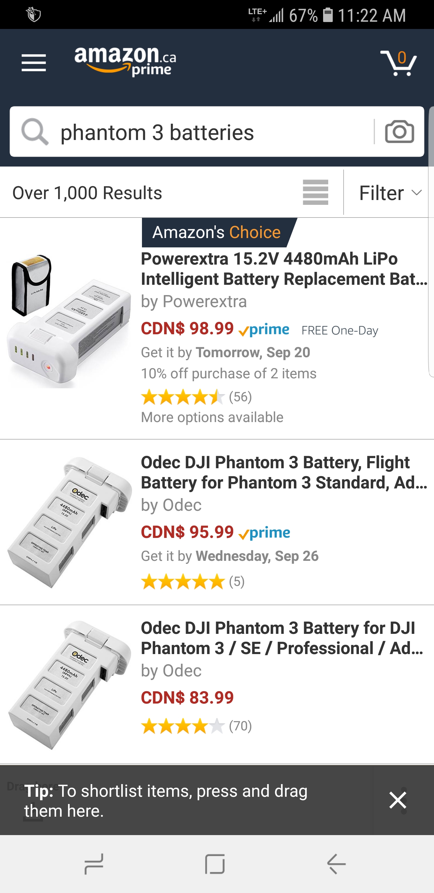

What does it say on the battery cells? I'm looking for extra batteries online and i found these brands (see attached screenshot) and according to the reviews they work for everyone. Are the ones you have either of these brands?
No on that. The batteries are exactly the same as OEM, the only difference being that these have Y- shaped panel lights, and the OEM has its lights running vertically, like capital I.
