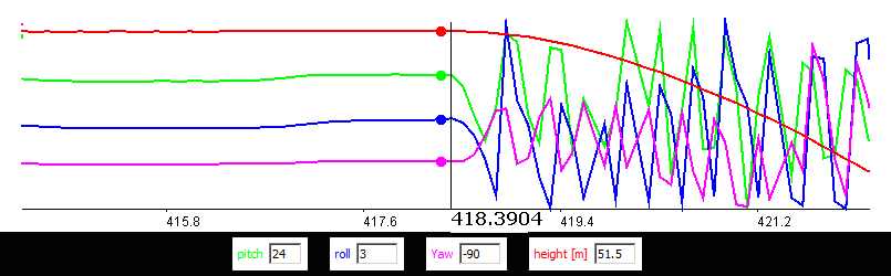

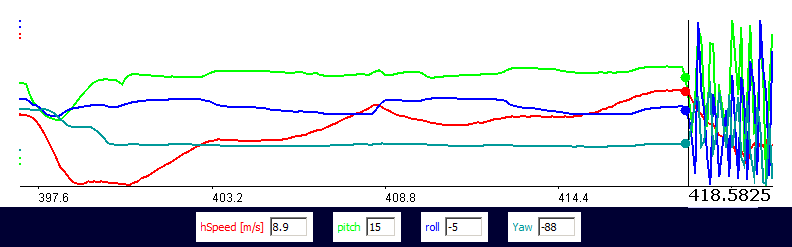

I think you're right. Either a lost/broken prop or a motor failure. Without the .DAT it would be difficult to distinguish between the two. But, almost certainly a propulsion issue. Looks like it happened at time 418 secs.
@rwparkinson I noticed you referenced HealthyDrones indicating a compass error. This always happens with a propulsion issue. When HD sees a rapid heading change it assumes that can't actually be happening and that the compass must be at fault. In fact the heading is changing rapidly because of reduced or no propulsion from one of the prop/motors.

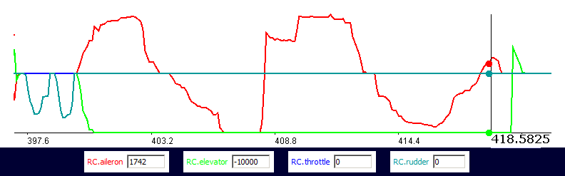

I am curious. Does the event correspond with a sudden change in speed or direction? Would that be a potential cause of an otherwise intact prop coming off?
In this incident there wasn't a sudden change in speed or direction.

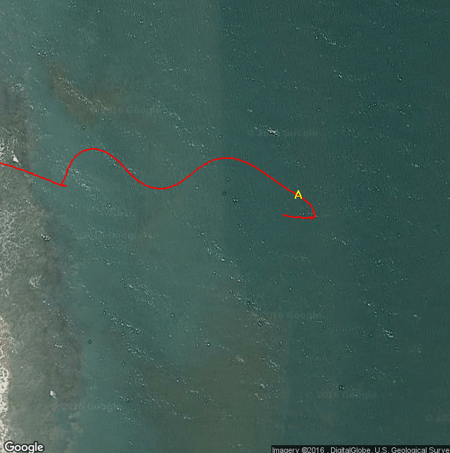

The hairpin turn at the end was after the propulsion incident started.
I've looked at the motor data for several flights where there was a propulsion issue. With a few of these it's been clear that the prop came off because it was found close to the crash site. But, there was no any indication of being related to change of speed or direction. It's a mystery to me how a prop can just come off after several minutes of flight.
