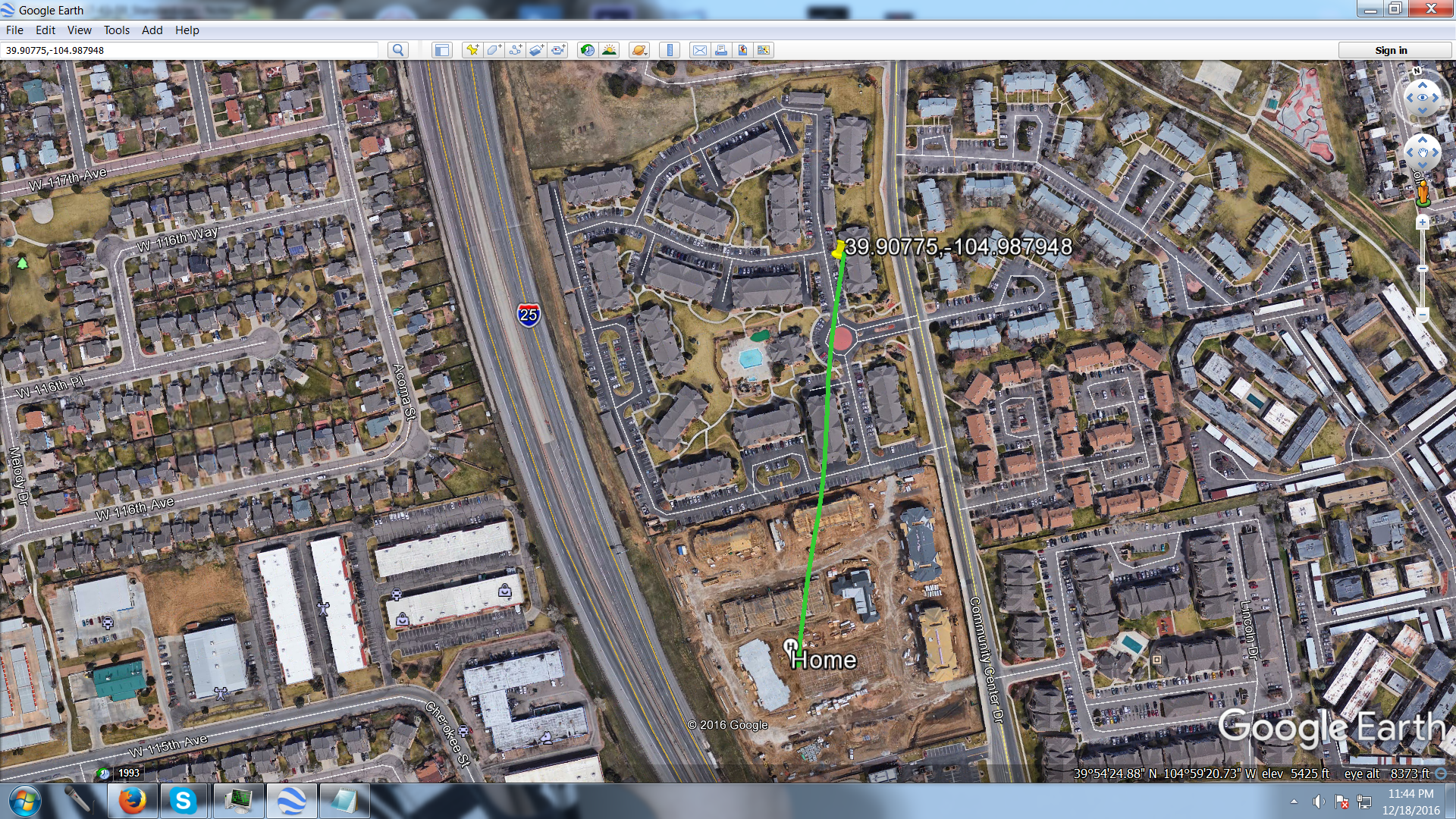

Did you search last know position? Did it land there?
Where was last way point spose'd to be at?
Just noticed... It's 2 houses... Might be worth knocking on the door, could be a telephone poll or wire around there

The entire flight plan has been searched exhaustively. The flight occurred right at dusk. We drove back and forth the length of the flight plan hoping to reestablish telemetry. My iPhone was setup to hotspot internet to the iPad mini 3 while searching. Airspace, the networking companion app for Autopilot, was run on the iPhone in hopes it may pick up the aircraft somehow. No signals were ever detected. The following morning we used daylight to search visually. My understanding is that if the aircraft decides it has to land, it will make that decision at a waypoint (before proceeding to the next one). The way the flight plan is constructed, the aircraft will not RTH until the mission is complete- since the last waypoint is home point RTH is removed from the aircraft's decision loop. Flying home is instead - part of the mission. The RTH button is part of my decision loop - much like a NASA range safety officer. If things go awry I use it. The RTH signal reaches far past the uplink signal and has never failed to pull the aircraft back - until now. My RTH altitude is 122 meters (402 feet). I have no evidence whether the drone executed that climb.
Also, the home point is 120 feet above the mid point area of the flight plan - So when the flight plan calls for 75 feet in this area, the net altitude is 195 feet. Accordingly 220 feet is 340 feet (below the FAA hard ceiling) ... all part of the plan. Tallest structures are 75 foot power line towers running N - S on east side of Washington Street.
