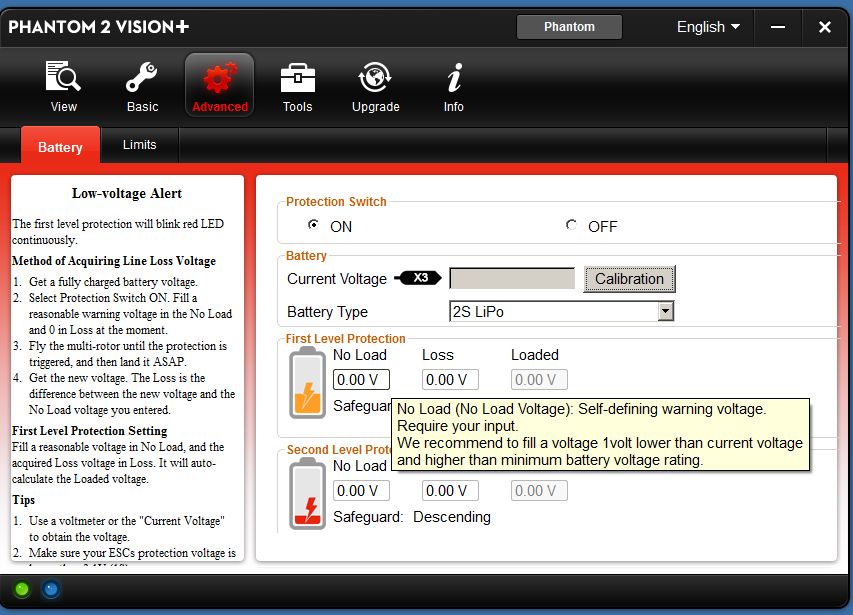

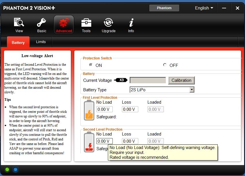

@jason
Jason have you seen these battery screens before, and do they make a difference to the P2 batteries
