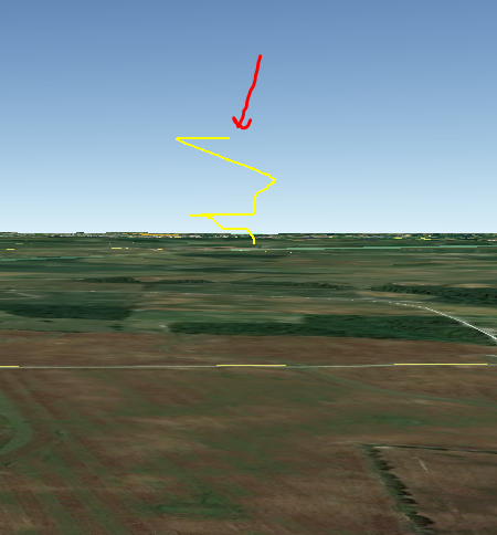

i lost my drone the other day and i was wondering if you guys could please take a look at the flight log.I just installed the ARGtec antenna and wanted to try it out. when i watch the flight on the ipad flight log it shows at the end where it just drifts off and i never regain signal.I went to the last known location but nothing. when i upload the file on airdatauav.com it shows i was always in ATTI mode,but the ipad says P-GPS mode. please help
No - it was continuously in P-GPS mode until 7' 23", when it switched to RTH. 27" later the record stops. There is no indication why that might have happened, but signal loss is the most likely. It was, apparently, trying to go back to the home point though. Was it windy? It was going at 40+ mph until it lost downlink. After initiating RTH it was struggling to make a few mph.

I contacted meta4 and he looked at the flight log. He said that the drone done everything it was supposed to do. It was user error because I didn't calculate the wind on the way back. It was only traveling 11 mph but on a straight path back to the home point. When the drone reaches 10% it auto lands so theirs a lot of area to cover.

That was an abrupt stop at altitude. Doesn't look like there was anything to block you signal. It's almost like the batter slipped out. Sorry you lost it!
It could not be battery loss, because it continued to broadcast video and telemetry.
Do you think the wind speed could have moved the drone back. It was in return to home mode and I know it doesn't use the full power of the drone
