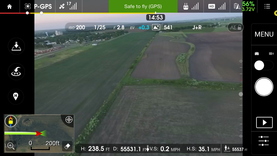

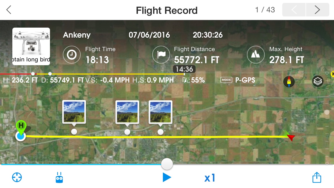

New personal best round trip for me, with camera on
Update me on the list please[emoji41]
55,750'
P3A w/ Bat mod & camera
Maxxrange boosted
143,584
1,471,696
105,600
