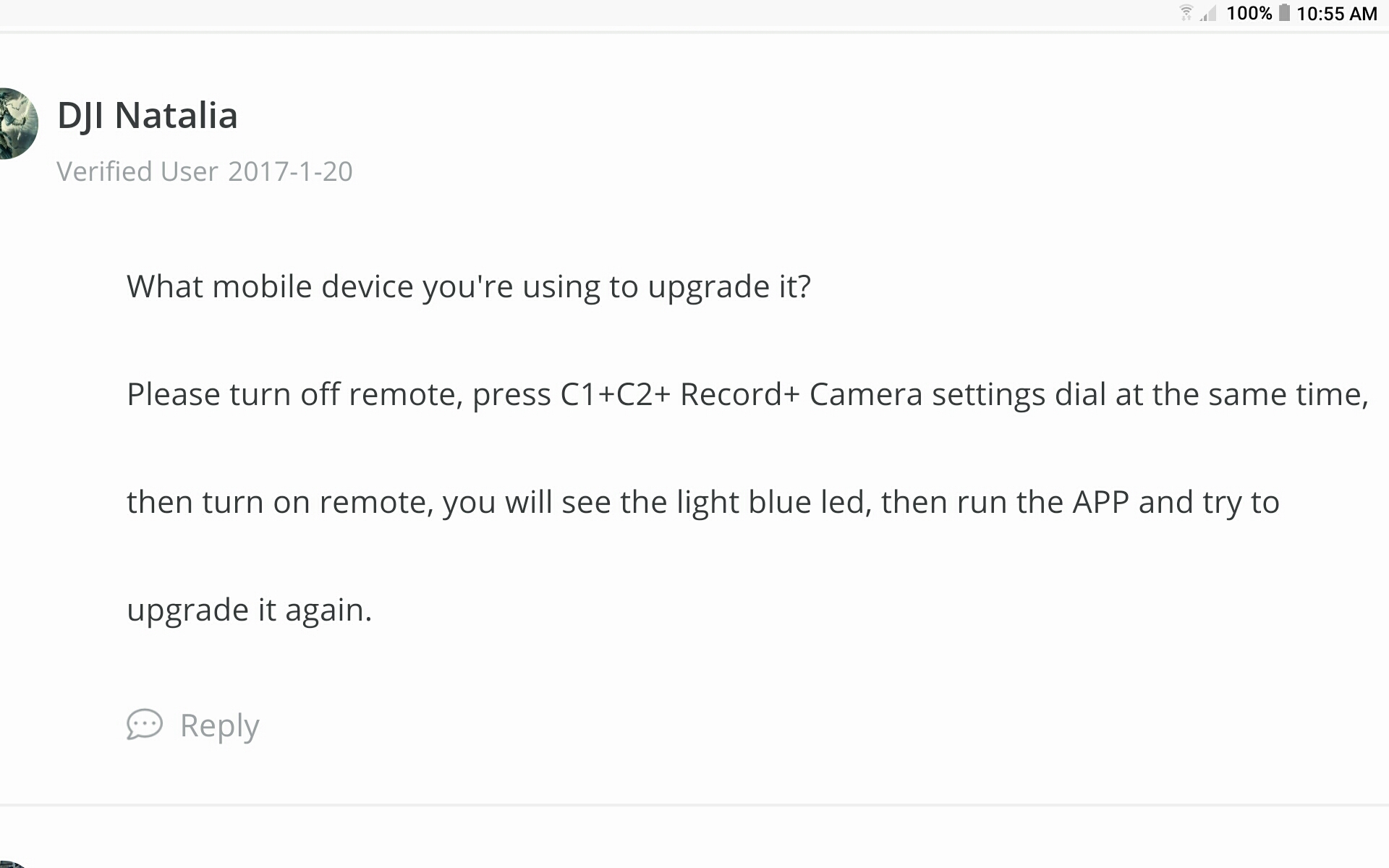

There's a thread on the official forum about this same issue it seems (including detecting as P3P all of a sudden etc). But no solution yet. Oddly the staff said to try holding C1+C2+settigns button to supposedly start the contoller and force a new install of the firmware, but that does nothing for me. Can't even find mention of that on Google.

Your close on the c1 and c2 ,but forgot the gimble wheel and cam settings dial at same time,,the dials work as button when pressed in
hmm, c1+c2+record+camera settings button (pushing in the wheel) does nothing / does nothing if I hold those while turning it on. ditto for using gimble wheel instead of record per your suggestion (do you mean just moving the wheel as far as it'll go? that wheel doesn't push in)
I googled this and found another post on the official forum that helped. You press c1 + shutter button + power button. Blue LED comes on. Press those again and the white lights flash. Then plug in your tablet and you'll be able to do the firmware again. I guess they keep changing the procedures...
