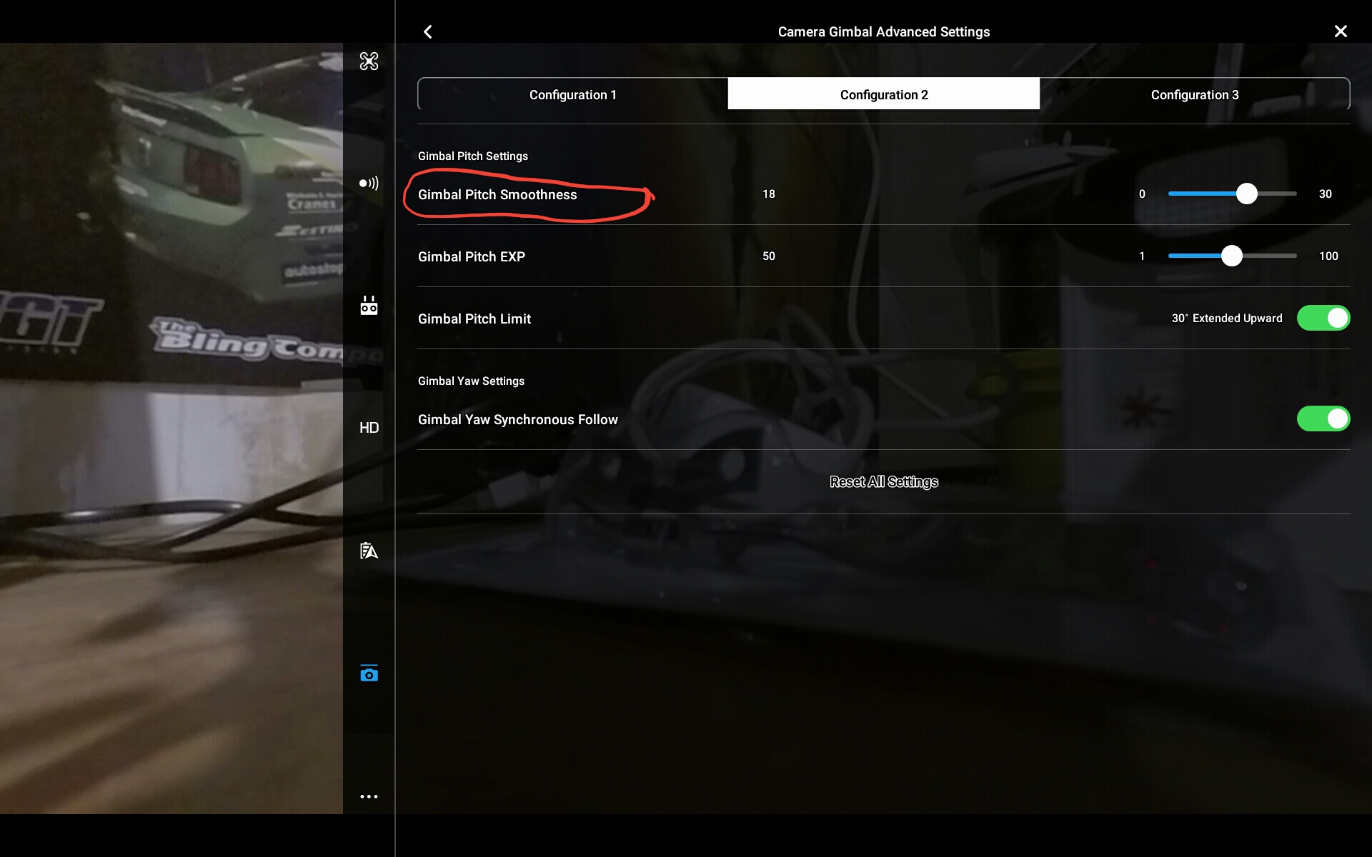

Agree with Nightwolf easy on the sticks,only just need to touch when turning and it be smooth turn also in you cam settings this one I circle controls how fast and slow you can make camera move so when controlling the gimble wheel it starts very slow so no jerky motions,,great area to fly :)
