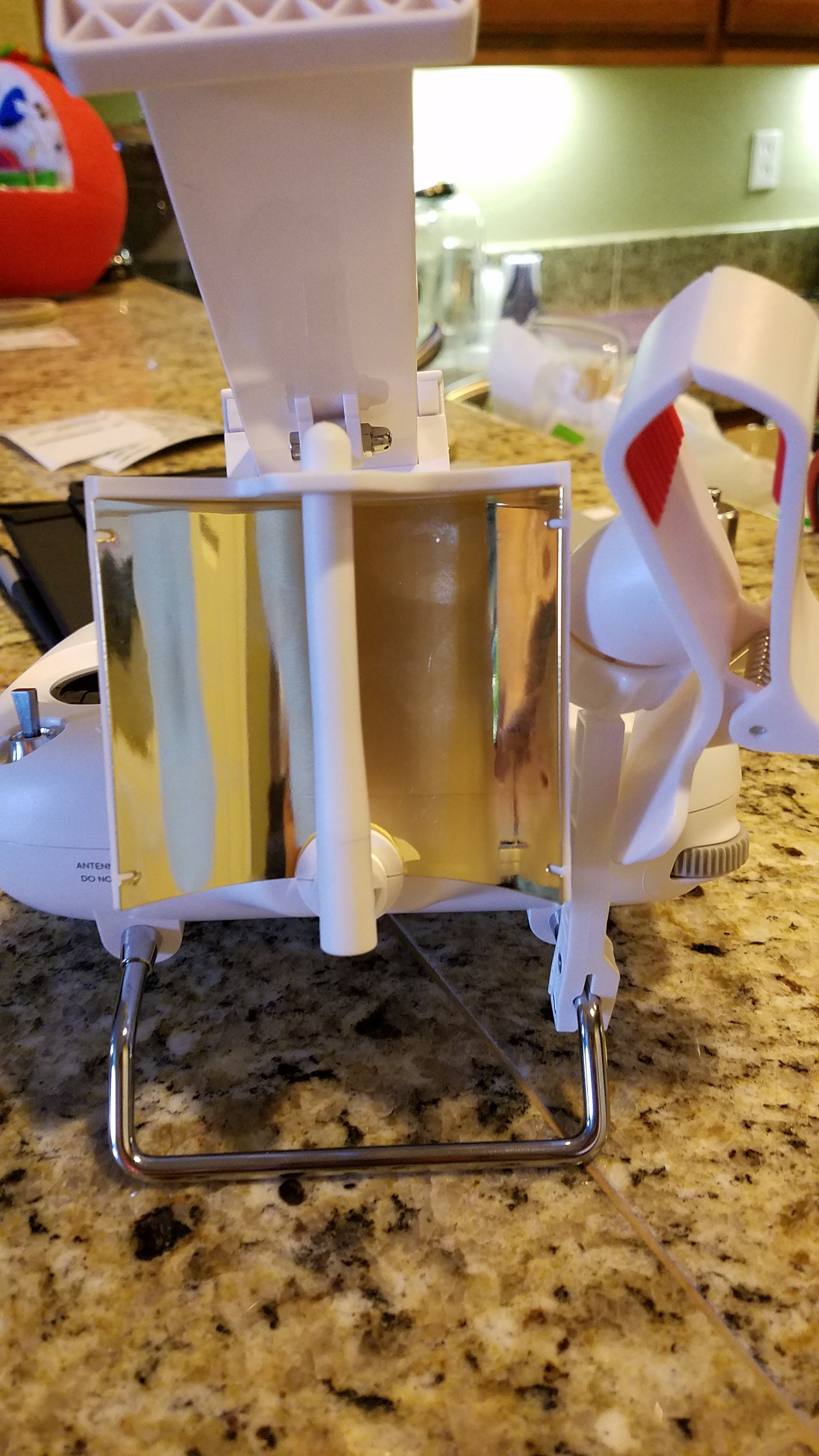

Bought one of those "parabolic" type cheapies - all i can say is, "Don't"
I got my return label and am sending it back tomorrow. It does absolutely NOTHING!!!!!!
Oh. Seemed to work according to the Meter;
Well I used it in an open field, no wind/clouds, no building or other interference and it did absolutely nothing! On another side note, I use a "parabolic" space heater and that thing works great!
I really wanted it to give me just a little more range. I wasn't expecting much but nothing at all was VERY disappointing!

Neither - it did nothing like it wasn't even on the unit :(
Maybe the guy in the video was too close to get an effective real-world reading?
