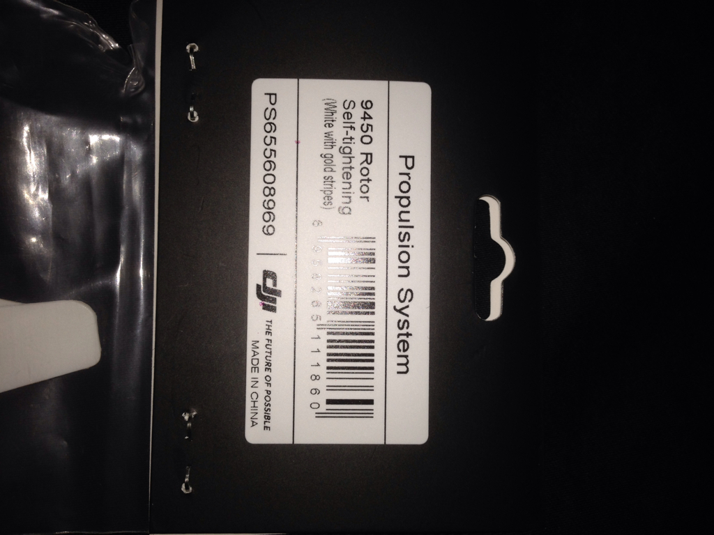

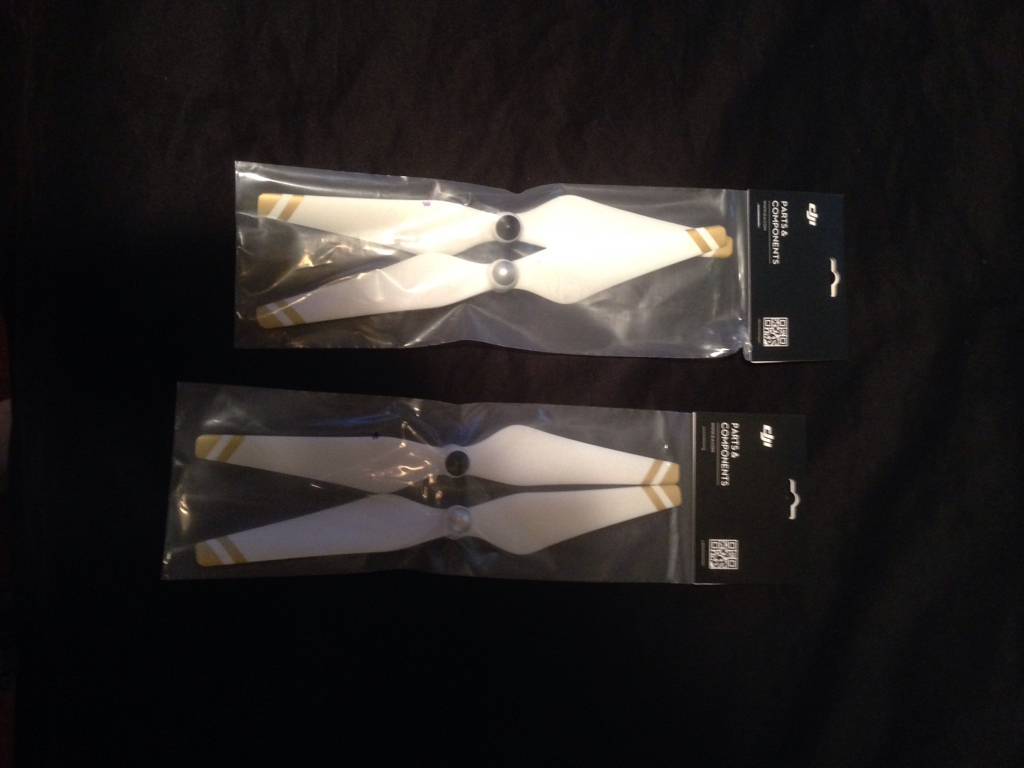

    Found these in my p1 box today. Not sure how they got there. These are p3 props correct? I've never had any with the gold stripes. ImageUploadedByPhantomPilots - DJI Phantom Forum1442877881.729041.jpg ImageUploadedByPhantomPilots - DJI Phantom Forum1442877894.994712.jpg

    Just make sure the threads are plastic not aluminum. The older props can spin off the p3.
    D4T_PoM likes this.

    As said above ensure these have a composite hub/plastic hub and mot aluminium and you should be good to go.
