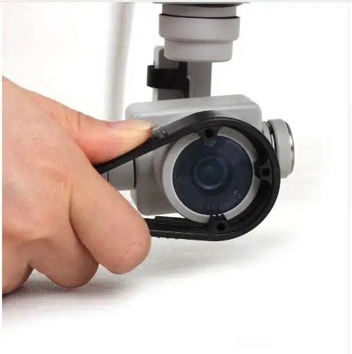

Could something like this be a solution?
[/URL]
(look at the second picture in the ad)
Yes

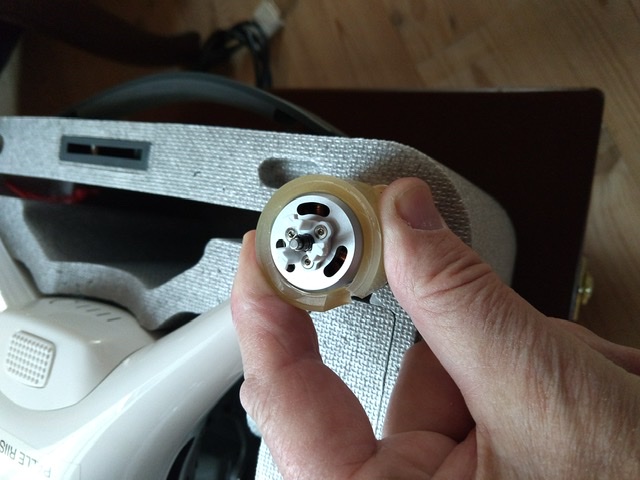

I have made a similar solution with a slice of a 1” silicone tube, to get a firm grip on the motor. It works fine.
The problem is that when it is so tight there is chance that something will brake.

Simply put, there are some tighter-than-need'be P4P V2.0 blades out there. Wrap a piece of innertube around the motor for grip and be sure to press and turn in the correct direction. It will come off with patience and the innertube piece.
