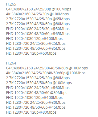

Hopefully, with 18-24 months between Phantom reboots the CPU's will have improved enough to handle 4K60 H.265 at, say, 150Mbps WITHOUT dropping frames or introducing image tearing artifacts that we now have.
The P4P does drop frames when trying to record 4096X2160 @ 60FPS., but if you record 3840X2160@60FPS, it's doesn't drop frames. That's likely a hardware limitation because DJI hasn't been able to fix it. It's interesting that they removed 4096X2160 @ 60FPS from their spec for a while, and now they have it back in the spec, as if it's fixed. P4P will never do 4096X2160 @ 60FPS with H.265, that's clear a hardware limitation.

The P4P does drop frames when trying to record 4096X2160 @ 60FPS., but if you record 3840X2160@60FPS, it's doesn't drop frames. That's likely a hardware limitation because DJI hasn't been able to fix it. It's interesting that they removed 4096X2160 @ 60FPS from their spec for a while, and now they have it back in the spec, as if it's fixed. P4P will never do 4096X2160 @ 60FPS with H.265, that's clearly a hardware limitation.

My P4P drops frames at 3840x2160@30fps, usually at a file boundary but sometimes in the middle of a 4GB file. The consequence of that is image tearing as I've demonstrated in a number of video including this one.
So, hopefully the H2 processor will not be as marginal as the H1 appears to be and the artifacts I and others see will be a thing of the past.

I've never seen an issue with drop frames when recording at 3840X2160@60FPS, even at the file boundary. It's as smooth as glass when I stitch two files together. I have other friends with P4Ps that don't have dropped frames with their P4P, as long as they are recording in 3840X2160@60FPS.
I assume you have tried different SD cards, correct?
4096X2160 @ 60FPS is a different story, the H/W can't handle it IMO. However I don't need this higher resolution, so I'm OK with it.

Those cards should work fine, however testing a second SD is a good idea just to confirm you don't have a substandard card by chance. If you continue to drop frames with both cards at 3840X2160@60FPS using H.264, I suggest asking DJI for a new camera. That shouldn't happen.
