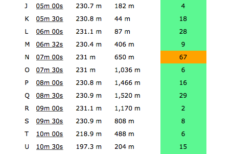

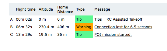

ok, looking at my log file said i lost signal for 6.5 secs today.
Nothing was apparent when flying.
Does it really mean lost, rather than fair ?
Does it really mean lost, rather than fair ?View attachment 30133
Hi Robin,
This means that the remote did not get data from the aircraft for 6.5 seconds - so the control downlink had issues. It is entirely possible that you were still able to control it with the remote and get video during that time, it's just an indication that this area may have a higher risk of interference in the future.

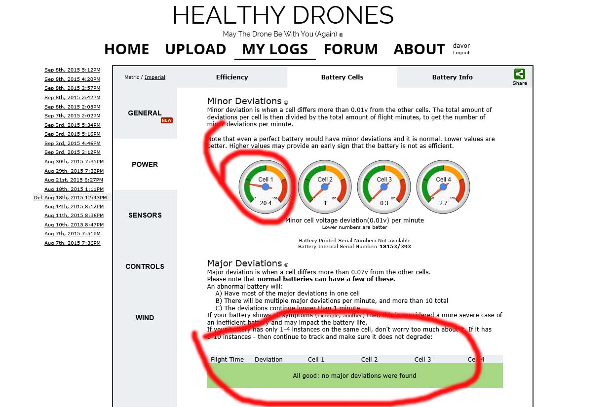

I have a suspect battery question. HealthyDrones notes this in the battery log. The flights are in sequence without any flights in-between for the battery in question.
Should I be concerned?
8/23 - Massive Number of Major Deviations, Cell 1
9/4 - Massive Number of Major Deviations, Cell 1
9/6 - No Issues
9/7 - No Issues
9/12 - Multiple Flights but with only 1 noted deviation in a couple
flights, Cell 1
I would recommend to keep an eye and avoid any record distance flights with it until you get more data.
