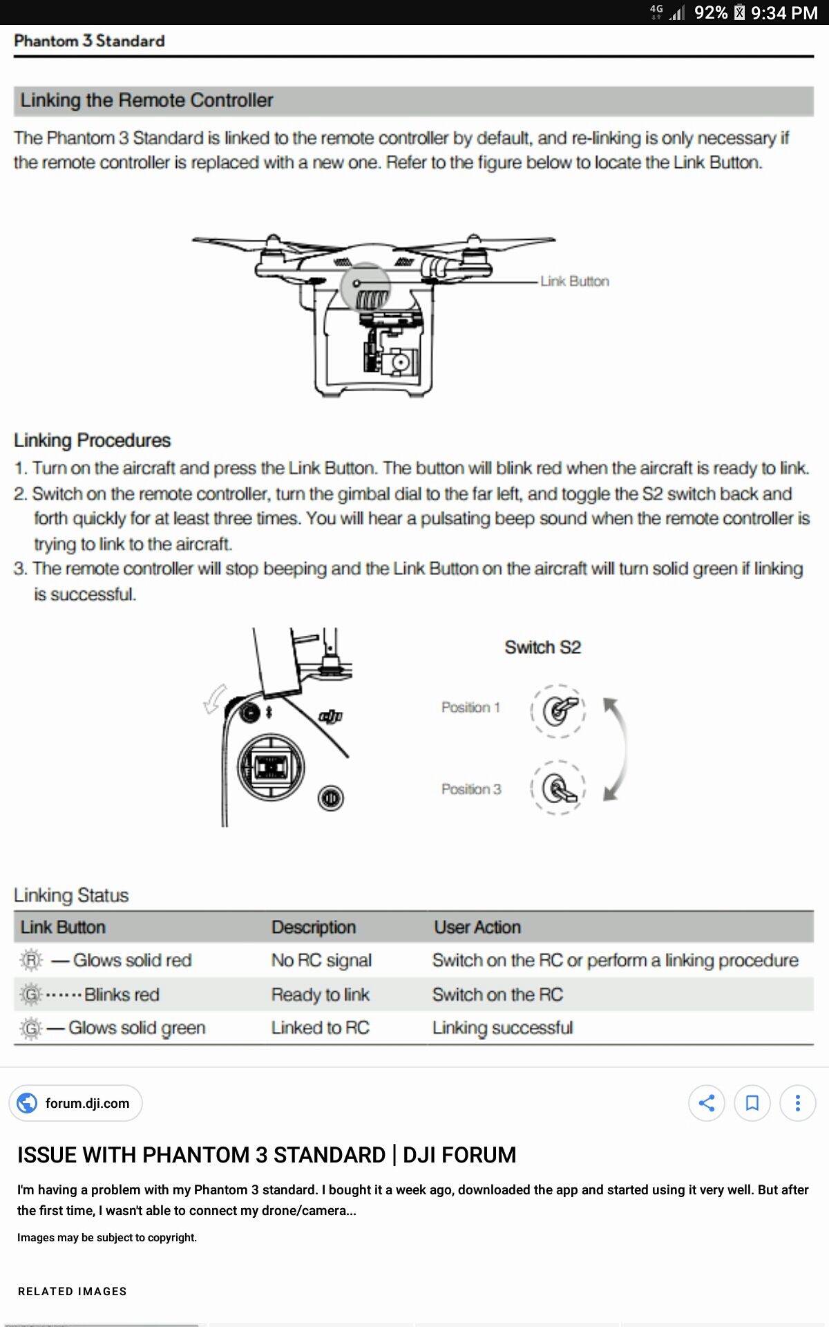

That totally sux,no sure about lack of response ,I think we all feel the pain and hard to advise in this situation, we'll yes sounds like got damaged in fall,like above ask does it still dance or limp when on,can you move cam with gimble wheel,any gimble light colour ? Yes I had p4 fall from high bench in earthquake,couldn't even catch it,I feel your pain,,,there is a manual relink if can't do in app,,
