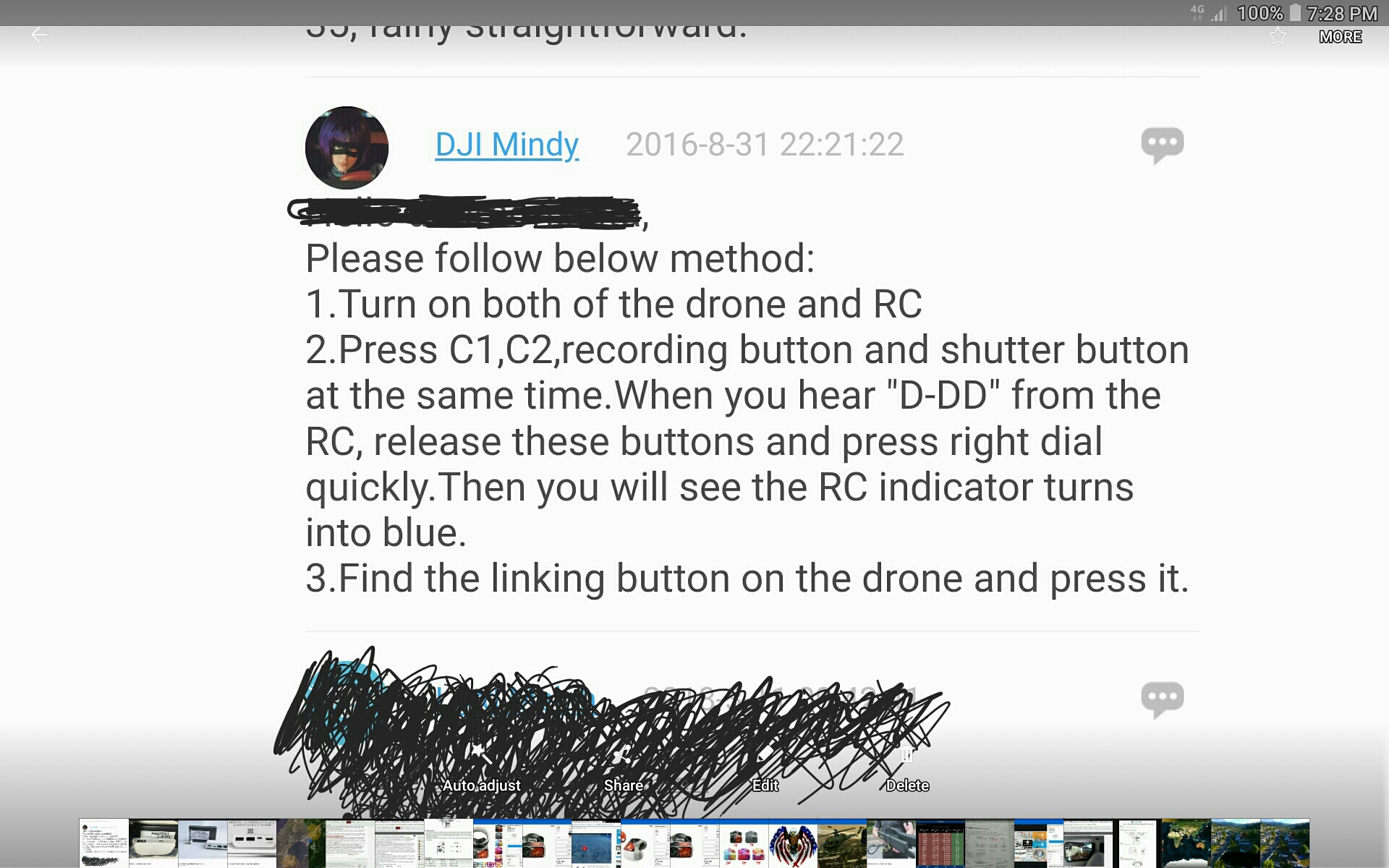

Sounds like it came unlinked ,,use this method if can't open app for linking under rc settings

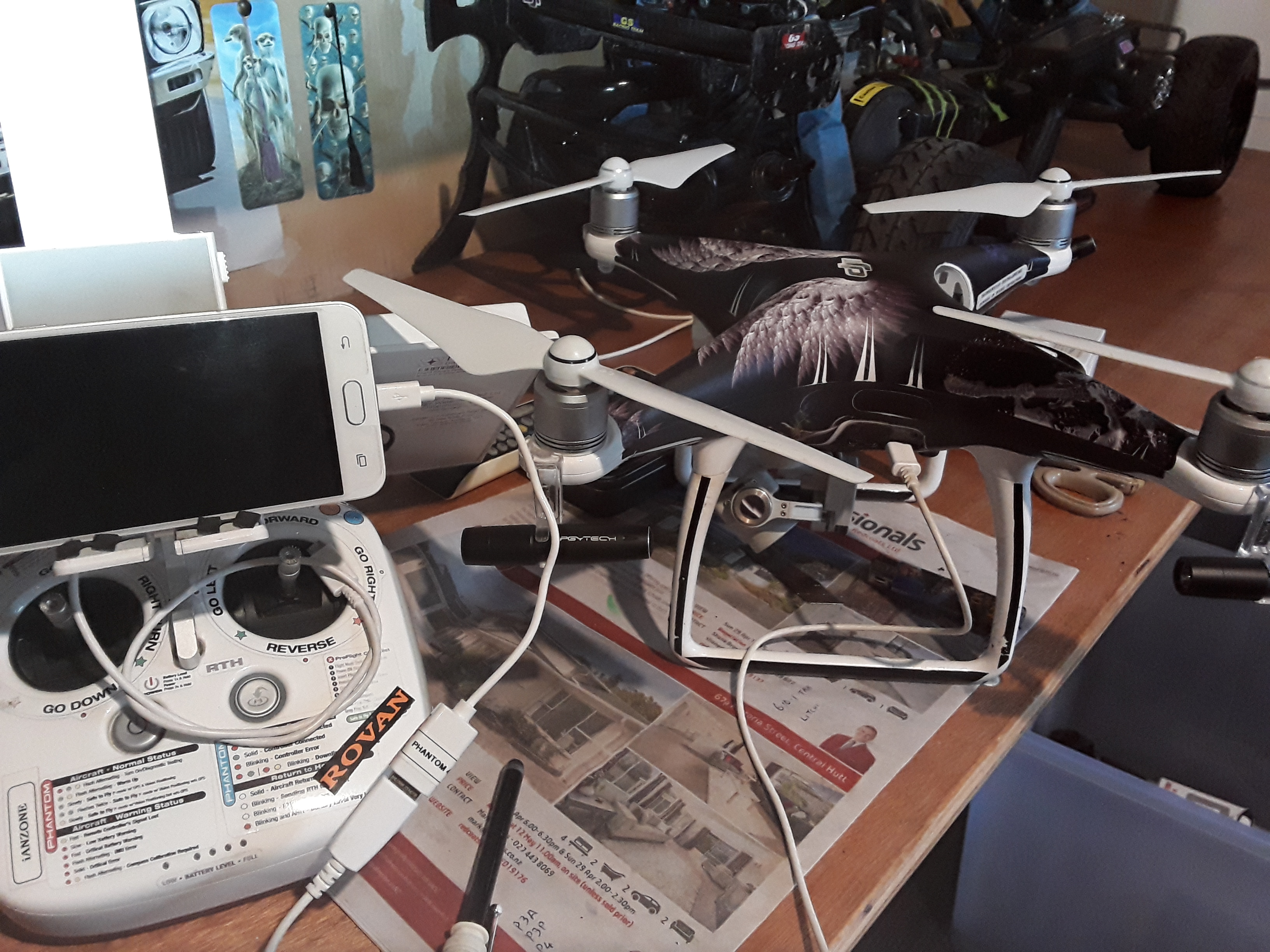

Just for record I have never used computer or assistant to update,never worked for me,I have always used my device,,here's a pic I posted yesterday to someone showing,device with Internet downloads zip file,then I usb with OTG cable adapter into my p4,,has worked evertime

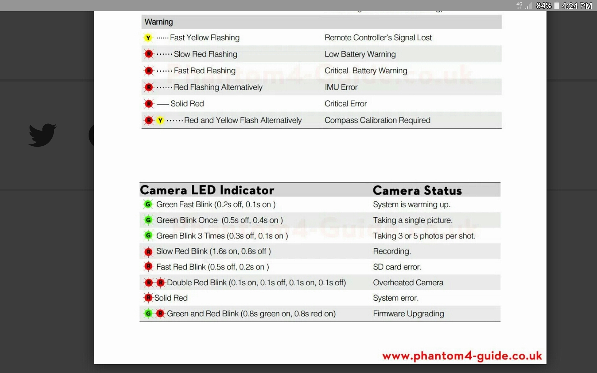

Can you tell me what colour are you lights,,remote colour, drone colour flash,camera gimble light colour
Remote is red drone is not flash anymore , and sound motor like faild to star up
Sorry me went flying,here's a light chart. To me it seems unlinked to aircraft but why drone not flash a colour,don't worrie about front red lights under motors at front they always red,back 2 lights under motor tell what drone is doing,motors won't start with red on remote which why I mention relinking,are you able to open app with your device and try rc link,what's the result,once you press this the link light on drone should flash till you press it,it times out after 60sec I think,,
Sorry me went flying,here's a light chart. To me it seems unlinked to aircraft but why drone not flash a colour,don't worrie about front red lights under motors at front they always red,back 2 lights under motor tell what drone is doing,motors won't start with red on remote which why I mention relinking,are you able to open app with your device and try rc link,what's the result,once you press this the link light on drone should flash till you press it,it times out after 60sec I think,,View attachment 100493
my controller is blink red
Is that the ones you posted up top,#2,my device can't open zip files to read or look,I have downloaded it but can't read it, I presume you mean front LEDs turned off,ok,what are your back lights showing,if you inside they might be yellow flash,don't want to sound silly but you need remote and drone and device on to work out what colour is where,they should be green or red or yellow flash on the rear lights,sorry for dumb question but helps to sort out fault,,did you try the relink in djigo4 app,,what happen
