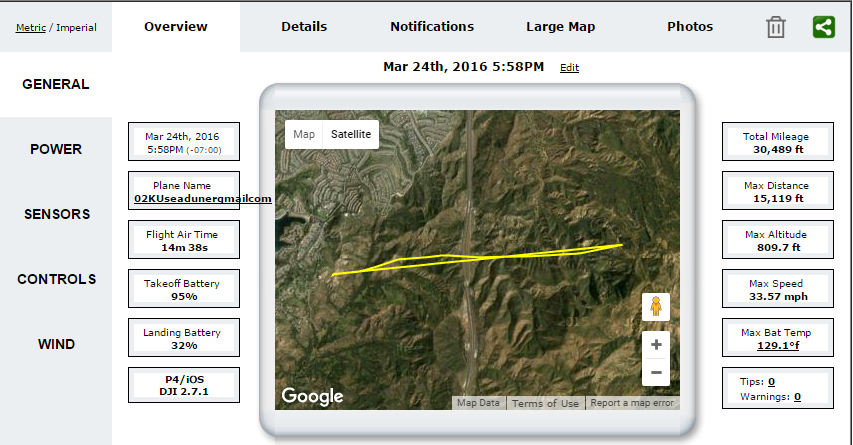

Here's a few suggestions to maximize distance:
1. Set your transmission quality to 4mbps
2. Check your RC channel radio interference. Manually choose a channel with the least interference. The channel hack providing 24 more channels helps find a quieter channel.
3. Try slipping on a windsurfer parabolic reflector set, one on each antenna. It's inexpensive and doesn't void the warranty. Works well. I got 15,000 the other day with my P4 using windsurfer, see below.
NOTE: I have found that flying around other Phantom pilots will take ALL channels from very quiet to very busy. This doesn't make any sense to me why two pilots can't manually select a separate channel and not interfere with each other. What happens when two pilots are near each other, the Go app will state poor communications in red font, deterring you from wanting to fly. Two times with someone flying Phantom nearby I've had issues, even when flying in automatic channel mode. I need to experiment more on this issue, but I was wondering if anyone else has noticed this issue.
When looking to select a quite channel, should I select one with a green bar, or one with no red or green bars? I'm very happy with the results I've gotten with the windsurfer I started using
