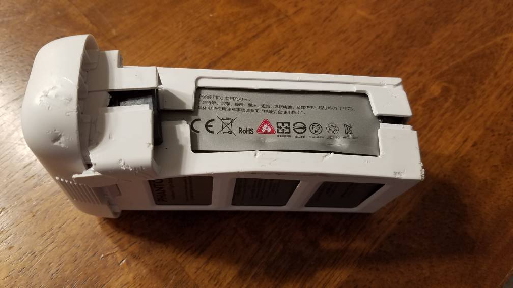

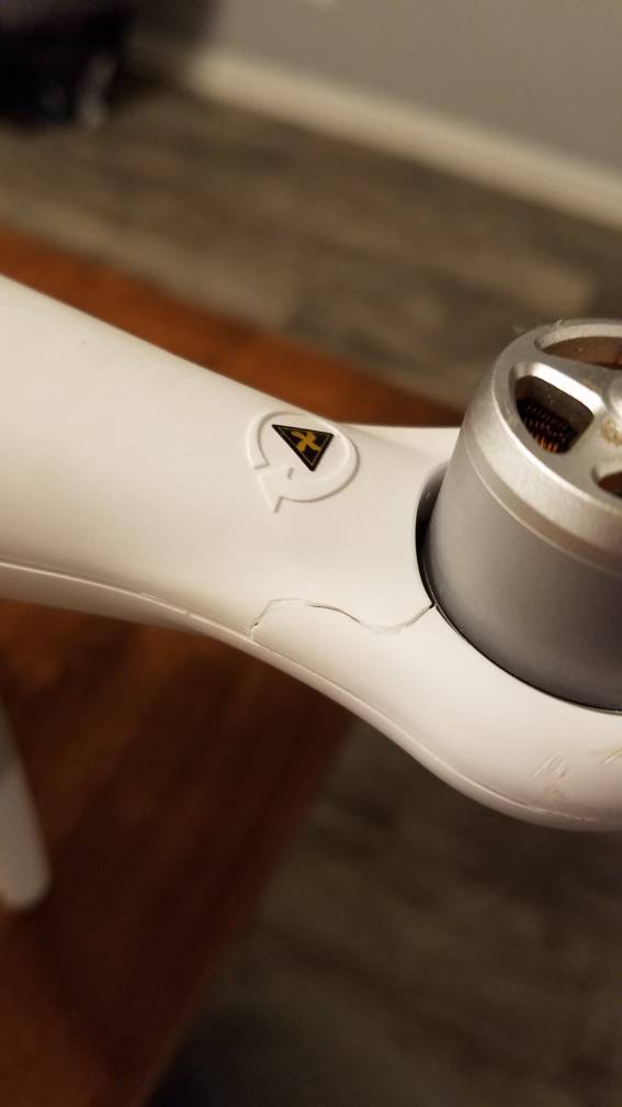

I've owned my P3A for 3 years and finally had my first crash. I lost line of sight behind a rock at the top of a mountain for a split second, lost feed, and slammed into that rock. After a very long, stressful hike, I found the bird after what seemed to be a miracle.
The battery ejected when it hit the ground and it seemed to be the biggest casualty aside from a crack in the arm of the upper shell and a shattered prop. There are some cosmetic scrapes and stuff but that's about it. The camera and gimbal escaped without injury due to the gimbal guard.
One of the gimbal plugs came disconnected but I plugged it back in and it seems to all function normally.
I haven't had to repair anything on this yet so I'm curious about how this goes. Can I just get an upper shell off Amazon l, swap it out and move on with life?
The battery seems damaged beyond safe use so is there someone out of the ordinary to properly dispose of this? Any and all advice to get this back up in the air is appreciated.
I think I’d try ‘Plast-aid’ on that small crack on the arm before swapping shells, depending on any other damage found that would compromise safe flight. Battery recycling guidelines vary in different locations. Just check around locally and see what your area requires.

A little bit of glue worth the cost of another repair?
I watched a guy years ago take a hammer after a bent bolt on an ultralight aircraft. A few weeks later he died in that same aircraft. I’m not saying this is the same, but the basic idea is similar. If you want to scrimp on any repair of any aircraft, not only are you putting yourself at risk, but also what it slams into when it fails. Do as you wish. Hope it works out for you.

It’s funny, as a kid we crashed RC planes, repaired them with glue/ epoxy/ monocote and were off again. I’ve plastic welded plastic parts and they are as strong as original. Depending on the cost of the repairs, and the availability of parts, complexity of repair etc I might consider doing it on a personal use bird. Not one I’d use professionally because I record all maintenance on it and the FAA probably would not like to see repairs to plastic.
If you try to repair, keep your initial flights far away from anything/ one and really put it through its paces.
Basically it’s yours, so it’s your decision. I don’t know your repair skill level.
Good luck. Some electronic stores take used batteries. Radio Shack comes to mind.
I can tell you from experience that a crack like that WILL causes stability issues. If it was mine I'd replace the top shell after removing it to see if any other damage has happened to that arm. You may need a complete upper and lower shell. That poor battery sure took a pounding!!

I'm with @3rdof5 & @Starz on this.. I'd never fly an aircraft repaired with damage as this... & then again I hear @Adamborz when he reminds me of how we (me included) repaired crashed & damaged RC planes, line control, etc & could hardly wait for the epoxy to dry to get back in the air..ahhhh the good ole days huh? Drones just seem to be more of a responsibility, because of the height they can attain & distance ?
Here's a shell I've personally used when hydro dipping, with excellent results, quick to ship too & the upgraded arm /motor mount area..
It's on e-bay...
Read & watch lots of videos on the swap.. take pictures, don't rush, use a egg carton secured to your work area for screws & mark them, it's really simple to do..

Wow for that cheap I agree that it’s a no brained to just replace the shell +1 @Phantom2USA

In any case, it seems the cost of a new shell isn't that much more than the product required for a repair and so I'll probably go that route. Hopefully with that and a replacement battery, I'm back in business. I'll do a lot of flight tests to make sure.

My recommendation would be to repair the crack with a strong glue, because it doesn't seem that bad (at least it didn't go all the way to the other side as per the photo). Then, test the bird in an open, not populated area and check the behavior of it, check if the aerodynamics is not deeply affected somehow. Do all the required calibrations and check the motors as well. Forget about the battery my friend... Good luck!!!

Replacing the top shell is a piece of cake. The lower, that's another story. I attempted a glue job on mine and decided to replace after the crack separated again. Takes longer to remove and replace the screws than to complete the rest of the job. There are lots of videos out there on how to replace just to top shell or to replace both. Bite the bullet, buy the shell and do the replacement. Adds to peace of mind.
