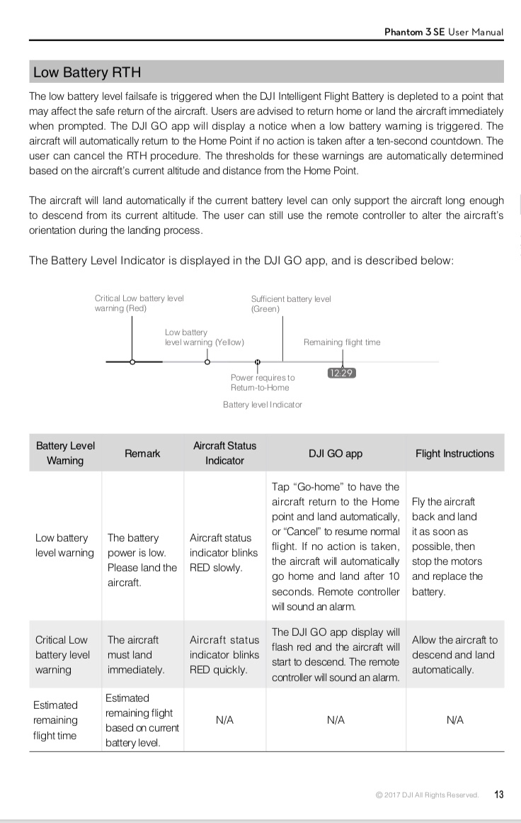

When the pre set low Batteries warning [emoji615]️ % is reach (Default is 30%) The go app has a pop up screen appear. You can choose to go home or keep flying If you choose nothing it will Go home. Interestingly it (the SE) should Auto land and not go into RTH if it’s less then 50 ft from RTH point If you need to cancel RTH quickly flick the S1 switch up &Down But man scary stuff when it doesn’t do what you are expecting

I'm Thinking that i was watching the drone Up that close and I Missed the pop UP screen that allows me to cancel RTH or keep flying.......But i still have a concern why all that's not recorded in the flt record....just to be sure ever things OK...I'm going to for the next few flights .Go fly in a Very very wide open area....and i will keep the drone in front of me..and...watch the screen for that message and YES i've seen it and canceled it and watched the battery level and i keep the drone 25 to 50 feet away and bring it close and land it when its down to 20%.When the pre set low Batteries warning [emoji615]️ % is reach (Default is 30%) The go app has a pop up screen appear. You can choose to go home or keep flying If you choose nothing it will Go home. Interestingly it (the SE) should Auto land and not go into RTH if it’s less then 50 ft from RTH point If you need to cancel RTH quickly flick the S1 switch up &Down But man scary stuff when it doesn’t do what you are expecting
Tcope.....I really Think that is what happened and with the drone really close to me....and them FOUR Spinning Blades....I was keeping Both eyes on the drone.....I had ear phones on and i heard that warning......But never looked at the screen to cancel the drones auto RTH.....But the missing flt record to show that is a mystery. still.Most likely there was a warning on the screen and you did not cancel it. The Phantom then did exactly what it was designed to do.
See page 12 ish in the Manual
