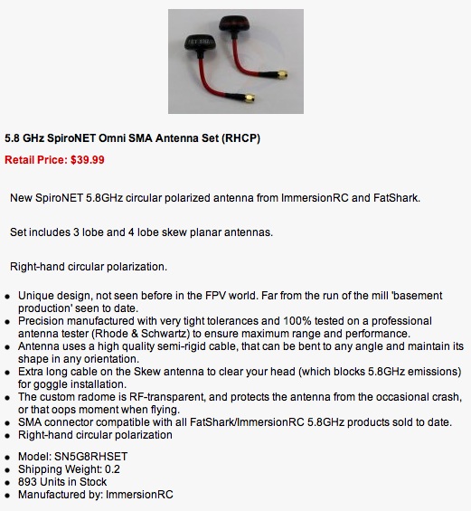

Alexmia would this CloverLeaf ant work as well? I know its more expensive but I just like how I can point it in the direction i want possibly getting better range.
I think that will work just fine. FYI: the cheaper newer antennas I am using can be bent as well, if that is what you are looking for. Not sure though if that will make much of a difference.
Alexia, yeah that's what I was concerned with. I ended up ordering the antennas you have so I guess it doesn't matter, ha ha. Thanks for the reply though.
