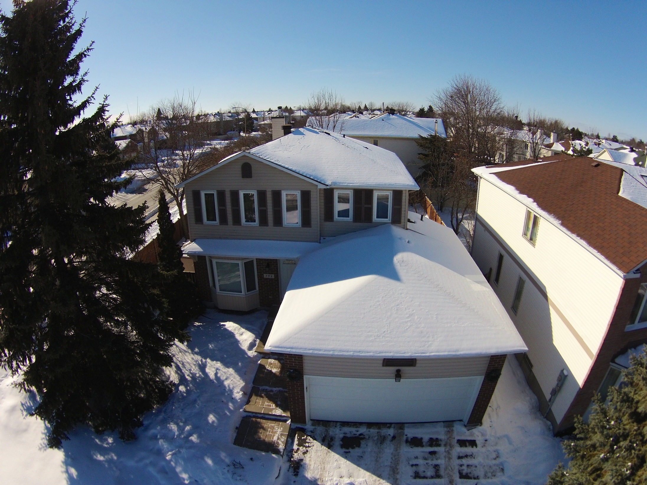

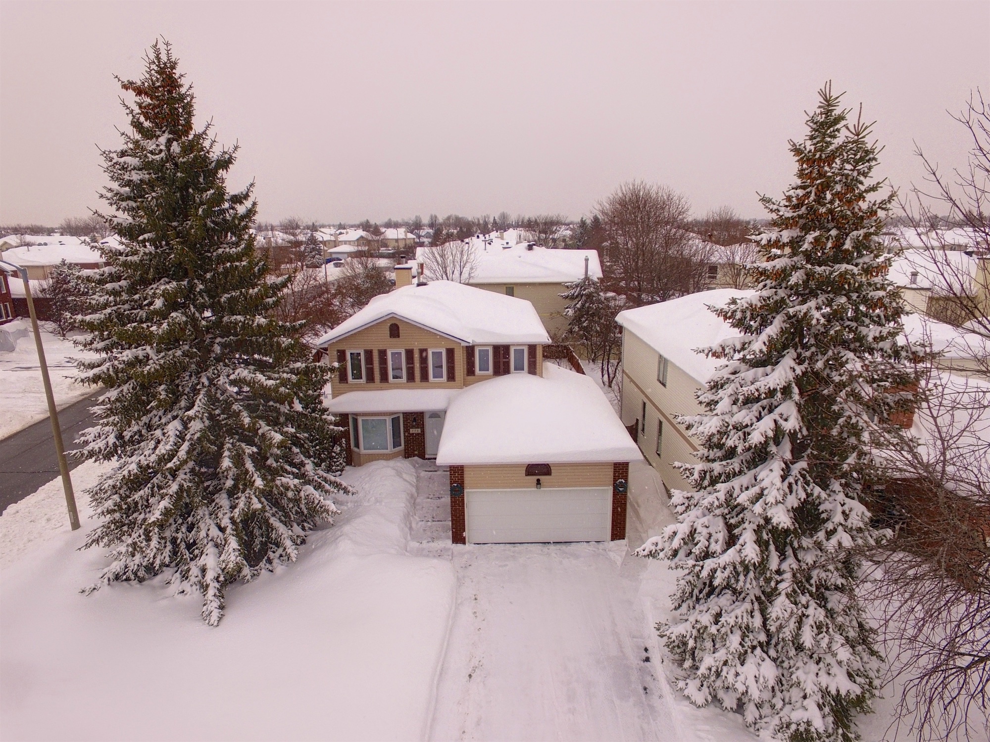

I found two photo taken earlier this year. The first photo is taken with a Phantom 2 Vision+ and the second photo is taken with a Phantom 3 Standard. Both cameras are very different than the Phantom 3 Professional. I can take test photos tonight with the Phantom 3 Advanced which has the same lens & sensor as the Phantom 3 professional. These two photos were reduced to 50% the original size for uploading. Photos were taken within the 10 meter range. Also to note: Photos taken in the cold of winter will effect the camera as metal and components tend to contract.
Thanks for taking the time to upload samples.
They do look sharper than mine.
Are they processed or jpegs straight out of the camera?
