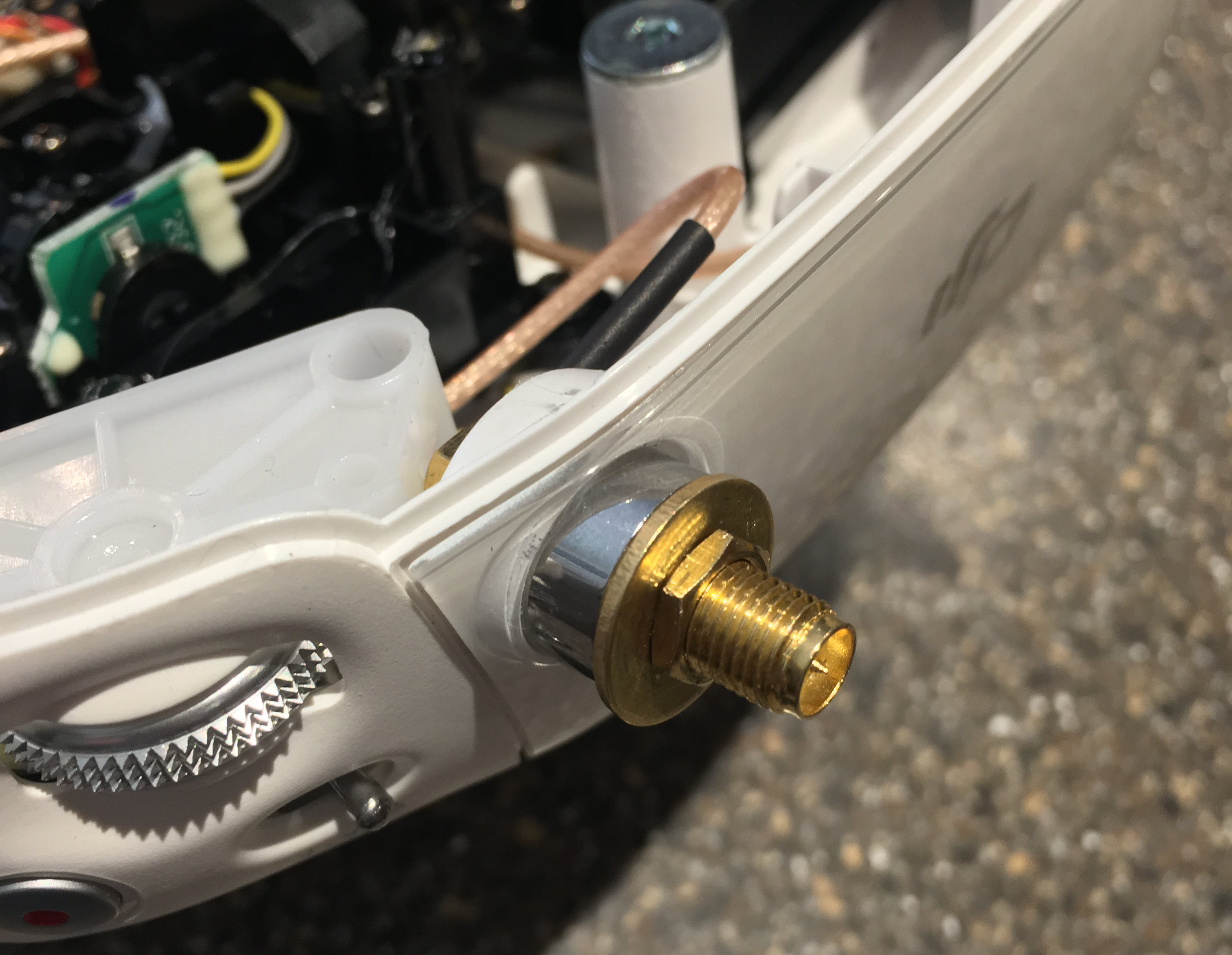

Make sure the internal antenna connectors are seated good.
The joint of the wire to the connector of the Clean Install kit is very fragile where it is soldered to the connector, so you need to be careful when installing. If I do my other controller I will put some hot glue on that joint first thing before starting the install process.
To provide a secure fit so they don't twist and damage the internal connection when screwing the antenna cables on and off, I added a larger washer (purchased at Ace Hardware) so the nut seats evenly on the "chrome" ring which allows it to be tightened enough to prevent the twisting.
This was after replacing the first set of cables which I damaged with the twisting. They don't have to be broken off to have a damaged wire. They still worked for close flights, but distance was limited regardless of which antenna was used. I am now able to go as far as the battery will allow with no signal loss.
Reactions: Zuzua
Hey @RocketBrew , we made some upgrades to the cable and we addressed those exact issues you described :) We increased the diameter of the washer and also doubled the thickness, so it goes over the silver ring. We also added a post where the solder is so it's much less fragile.
For those who have are having any issues with the first version of the internal cables, they have a lifetime warranty, just contact me to get a replacement :)
Reactions: KyleMaxxUAV
Hey @RocketBrew , we made some upgrades to the cable and we addressed those exact issues you described :) We increased the diameter of the washer and also doubled the thickness, so it goes over the silver ring. We also added a post where the solder is so it's much less fragile. For those who have are having any issues with the first version of the internal cables, they have a lifetime warranty, just contact me to get a replacement :)
When I first had this issue, I contacted Jake to see if he could make a 3D printed insert to firm up the connection.
Jake replied surprisingly fast, and suggested using the larger washer, which also took care of the problem I had with the chrome ring slipping off.
After reinstalling with the washer worked out so well, I have been recommending it here to others that were having similar issues with their installation.
This quick response of getting a revised design implemented in just a few weeks, then providing it as a replacement to customers who had a problem at no cost is another great example of why Jake has earned a reputation for great customer service.
