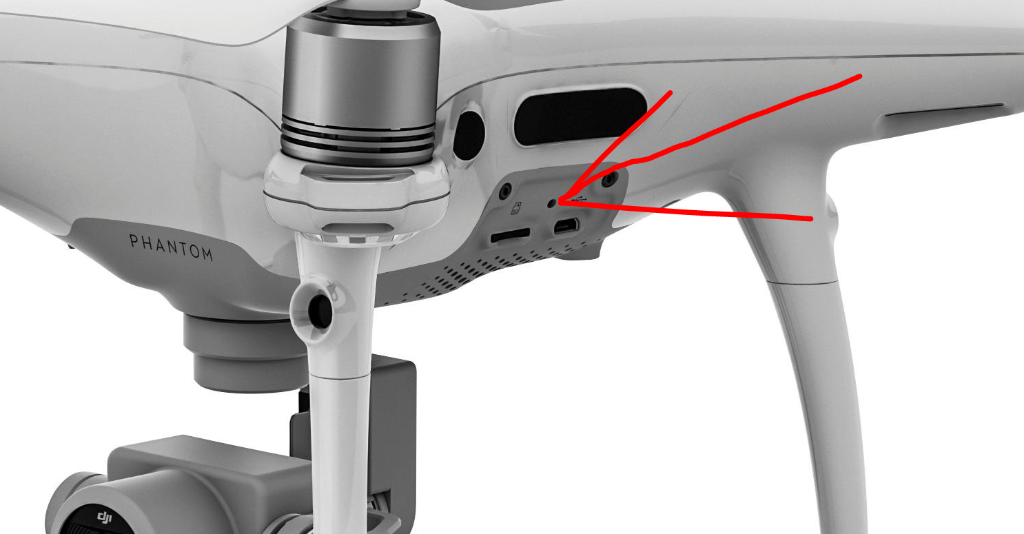

Link button on the P4P is not on the gimbal it is on the port side next to the SD card slot. Should link fine without the gimbal.
P3’s are on the gimble.

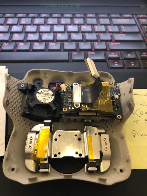

I do have cameras that are refurbished. I am going to check to see if u need the whole camera or just the top
Reactions: Capt KO
OK, I just took just the top with out the gimbal and it did link.

Yes you can fly a P4P without a gimbal, but ONLY if it has been previously linked.
Well...I assume you mean gimbal assembly, which includes the controller and other bits that are not actually the gimbal.
The link button is on the gimbal.
It's not. It's on the gimbal *assembly,* which is the controller for the gimbal. The button is not on the gimbal.
