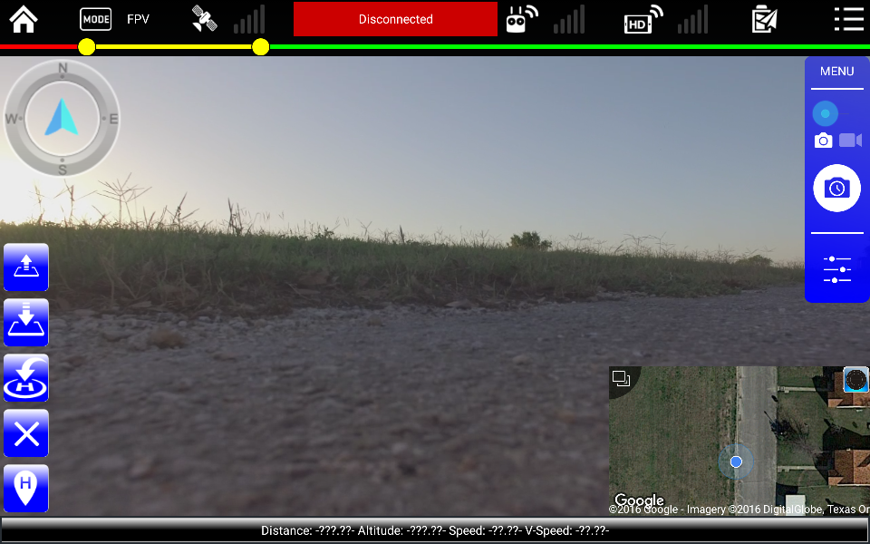

I purchased the app today. I really like the layout and how it full of features. However when I'm using the app it says that my P3p is disconnected, I am able to still fly and control my quad, a can see the images from the camera. I am running the latest firmware on my P3P. Here's a Screenshoot of what's going on.

From the image it appears that the flight controller didn't connect to the SDK. When you connected the USB cable did you get a prompt to select the app that should be connected?
There is a troubleshooting section in the documentation: http://djiultimateflight.com/images/DJI Ultimate Flight V3.pdf.

Yes it does prompt me to choose the app
