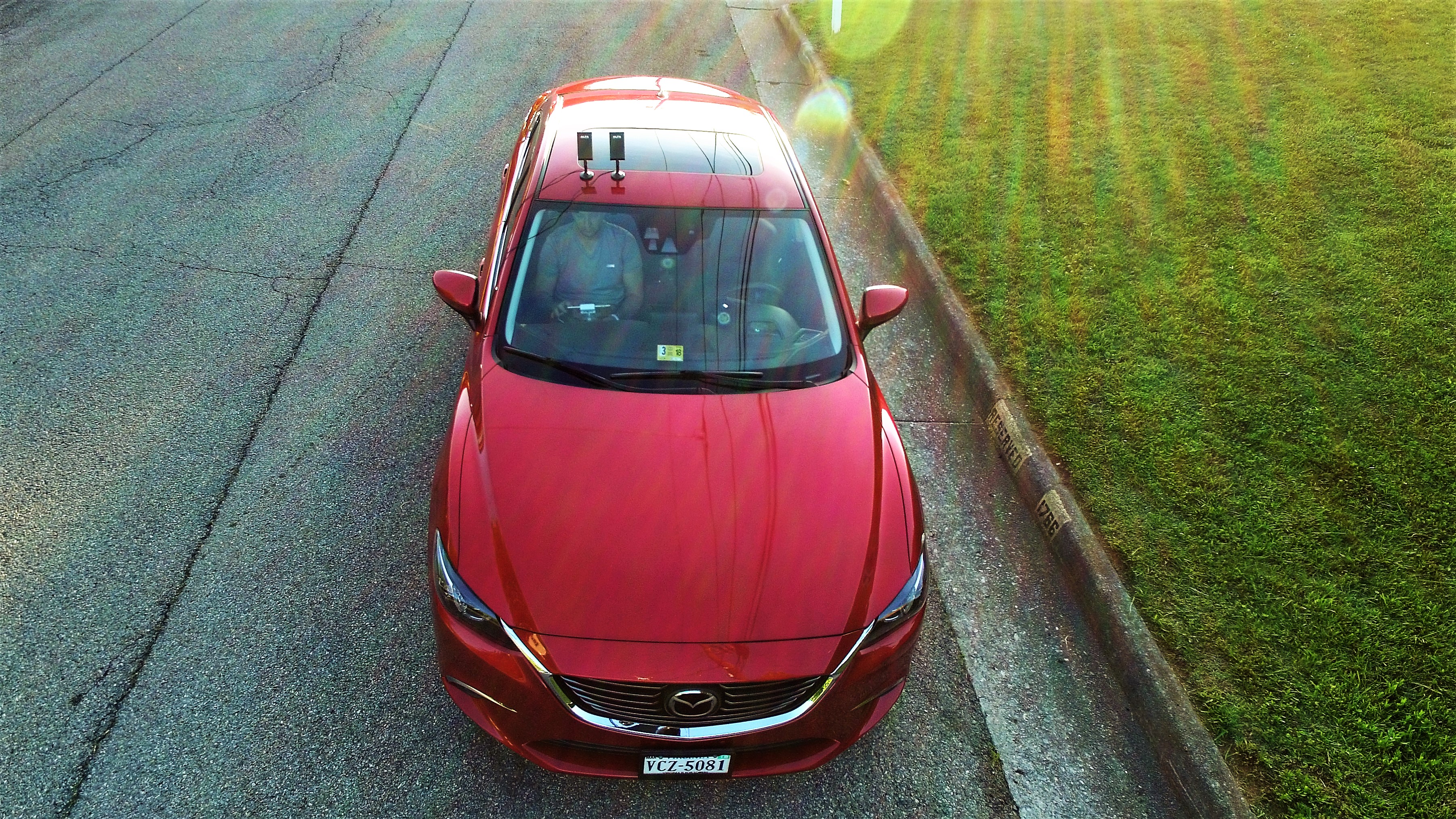

I had a chance to try these out today from the street front of my house. My neighbors gave me weird looks.
I flew down the valley over a neighborhood with plenty of potential WiFi interference. I went out a little over a mile at about 100ft altitude. I had full bars out and back.
I will go out a little further tomorrow. It was pretty nice not having to worry about sun glare whilst sitting in the air conditioning listening to the radio.:cool:
Reactions: Oso
The seller also has shorter cable versions. I have ten foot cables, which worked out pretty good. I can stand outside of my car with the antennas on top of the car and the cables connected to the remote. This way I can take off and fly out a little, then get in the car and finish flying from inside. I can just leave the extra cabling hanging outside the car or in the floor.
