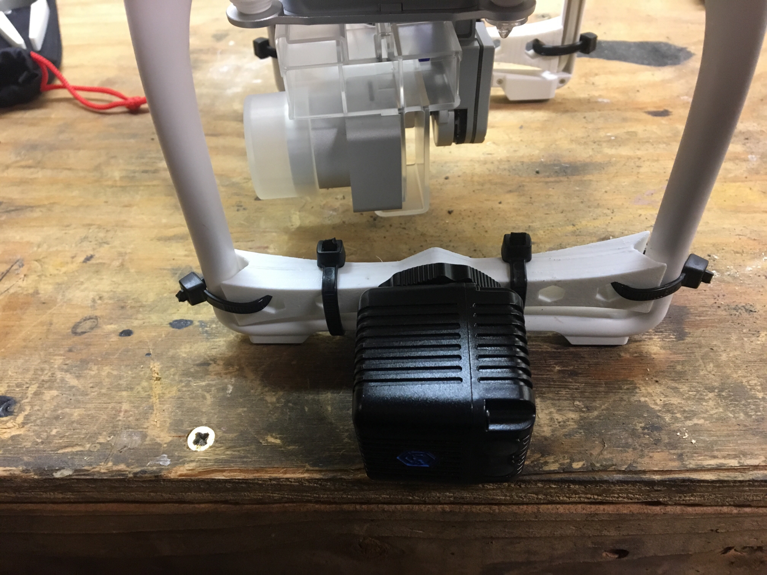

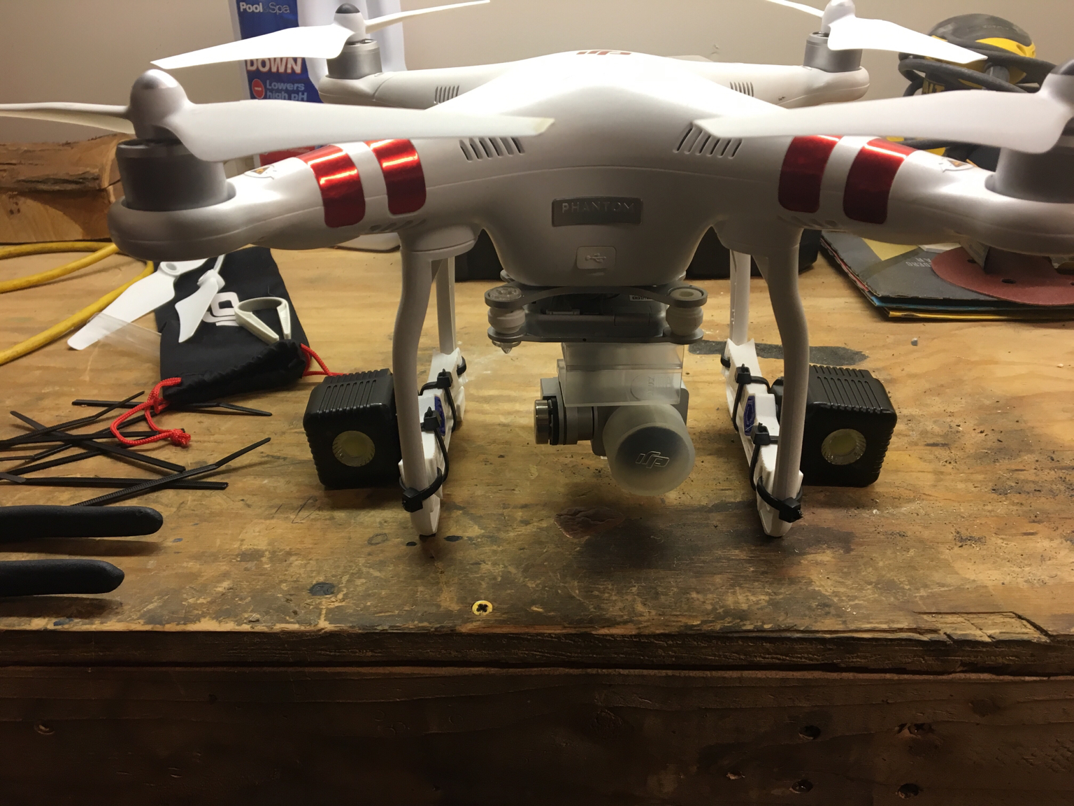

I want to put lume cubes on my phantom 3 STANDARD. The problem is the mounts supposively are not compatible with this drone. They do have mounts for the advanced and pro models. Has anyone attempted doing this yet? If so, can you share with me pics and what you did to attach them? Thanks
You might find a nylon cable tie at a hardware store and fit it around a leg and use a short 1/4-20 bolt into the Cube. Surprised their P3 Advanced bracket doesn't also fit the P3 Standard so something is different, maybe in the length between the leg uprights where they wedge into.
Something like one of these: Cable Ties and More
I have the LC on a P4 and the first set of mounting brackets broke in half as they were too thinly printed (They are some cheaply printed 3D things!), but LC replaced them with a bit heavier version in the middle by 1mm or so. They wedge in pretty tight and mine snapped in a week of being on the legs. Actually, a nylon cable wrap and bolt might be less weight than the bracket which might give you a bit more flying time too. The things do reduce flight time a few minutes as they weigh around 300 grams with their brackets.

You'll have to take them off the bird as they do stick out a bit on each side to put them in a case even with their brackets. They have to be plugged in to a USB type charge for a couple of hours too so I bought one of those ban 2 amp chargers rather than use one US cable and spend 4 hours charging two of them. Run time at full brightness is about 23 minutes or one flight. They are purplish in color too and not daylight and I see they came out with some CTO filters to address that, but the holder is magnetic and heavy too, and could that bother the compass? I don't know.

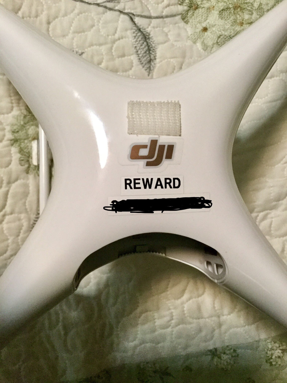

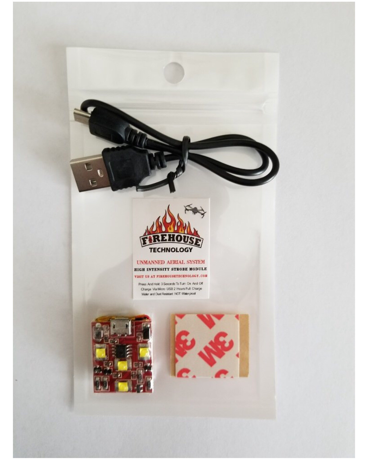

I use the High Intensity Cree light System from Firehouse. I use Velcro instead of the 3M tape so that it isn’t permanent and I can take it off so that there would be no problem putting the bird back in the case. I don’t use it to see my drone at night so I mount it on top so that any aircraft flying low ( helicopters, planes coming to land near airport) could see it.
That is a ingenious idea for more compact anti-collision lights.
