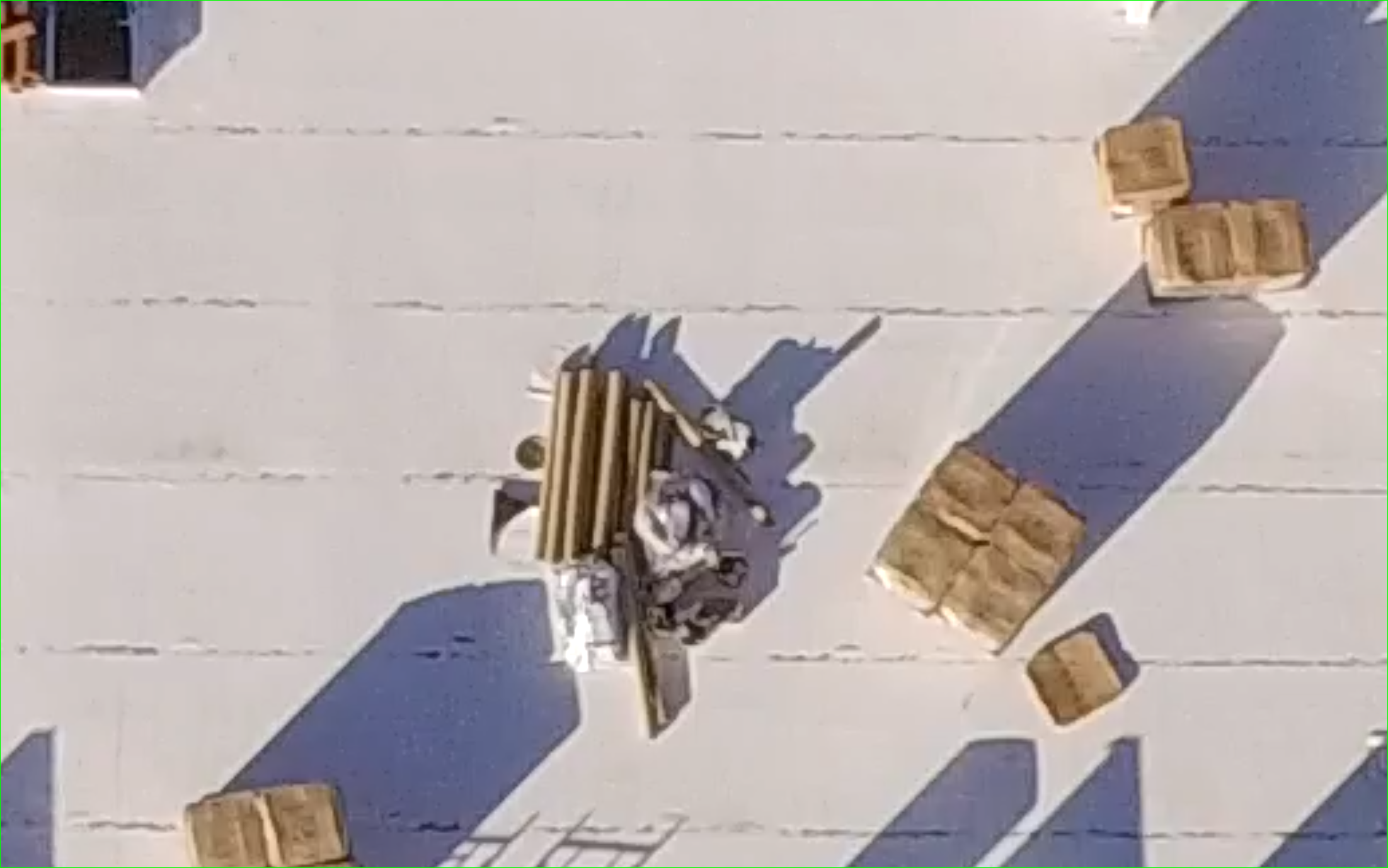

Shooting your highest resolution @ 100' AGL should give you lots of detail. I can almost read a license plate @ 250' AGL. I see that you're shooting crops. At 100' you can zoom in on a mouse. So unless you are scrutinizing individual kernels of corn, 100' (30 meters) should work extremely well.
Here's a screen capture from 4K (UHD) video @340' AGL. The roof is about 40' high, for a net difference of 300'. Now imagine your still photos (which would net a higher resolution) @ 100' AGL. From this shot we can see a bucket. From 100' AGL I would be able to tell you what's IN the bucket.
