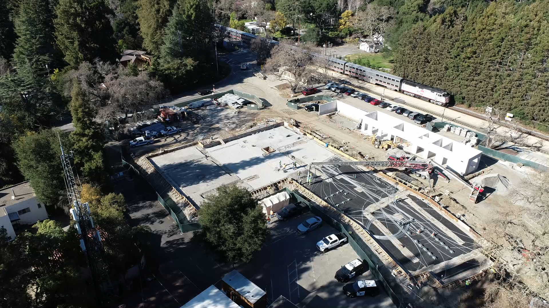

I bought a Mavic Air a year ago for practice while I studied and obtained the FAA Remote Pilot's License. At first, flying it made me very nervous, and there was a lot to learn. However, flying the MA helped me realize that I wanted to become a professional. I easily passed the part 107 test, and my construction company bought me a new Phantom 4 Pro V 2.0. I hardly ever fly the MA anymore, because the P4PV2 is Awesome, and the control range is Amazing, so much better than the MA! My company also gave me a big salary raise with my new qualification. I tell this story to encourage you to take the test, and purchase a new P4PV2.
