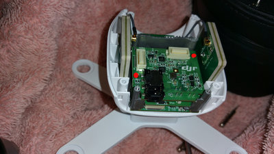

I think I found the problem, or at least the area where the problem lies. @dirkclod you suggested something getting hot and also mentioned the transmitter was in the camera. After getting more error messages I finally opened the camera. I have attached pics of what one of the wires looked like. It had been caught between the case and the rear of what looks like the lens housing. It has a pretty good crimp in it. I probably should have looked further but I didn't, I just moved it so it wasn't crimped anymore and put the camera back together. I took it out to test it and it wasn't any better, in fact it was almost worse. So, can the actual wires inside that wire casing be damaged beyond repair? Since it's not crimped anymore but still not working do I need to look further or just replace that wire? If I need to replace the wire, does anyone have a trustworthy dealer where I can order one? Seems like the more I find out the more questions I end up with.....TIA

If that's one of these FC200 antennas.jpg that go to one of the antenna patch's it does look messed up . That's just one side and would seem it not working would only restrict your distance . As far as where to get the cable I don't know . I don't know if you can even buy one new . I just sent about 4 of those to a member and he might have not used them or have one left . I can see . That panel comes out easy enough but the connecter on the board is a little tricky . There is a YT video showing a easy way to do it and can find it for you if you wish .

Yes it's one of the wires that attach to that antenna circuit board (I think that's what it called) When I did the DBS antenna mod I had to take out the two antenna's that were in the wifi extender. They look exactly like those, think I could put those boards in the camera? unless of there is soldering involved then that's a "no go" for me. I did see a how to on YT about doing some antenna mod on the camera antenna's. If I thought doing that would fix the problem I'd do one of those antenna mods to go along with my DBS mod.

I crimped one of those cables taking mine apart one time as if it's not placed just right the case will crimp it . I cut that part out
of the case doing the antenna mod you speak of . As far as contacting DJI with a opened up camera ...good luck .
It's a long shot, but you could contact DJI with the pics showing the damage. Obvious manufacturing defect.
Ken ..didn't mean to jump over you but in the OP you see the camera had took a hit so I don't think this a manufacturing defect..
I emailed DJI tech support last week and still haven't heard anything so I doubt I would get much of a response from them on this wire. Even if they did respond I doubt I could prove it was Mfg defect since we did have a hard landing and the camera was affected. From what we know, or hope we know, would doing an aftermarket antenna mod fix the problem? If that crimped cable couldn't cause intermittent wifi failure, what else could? Is there a fix short of buying a new camera?
