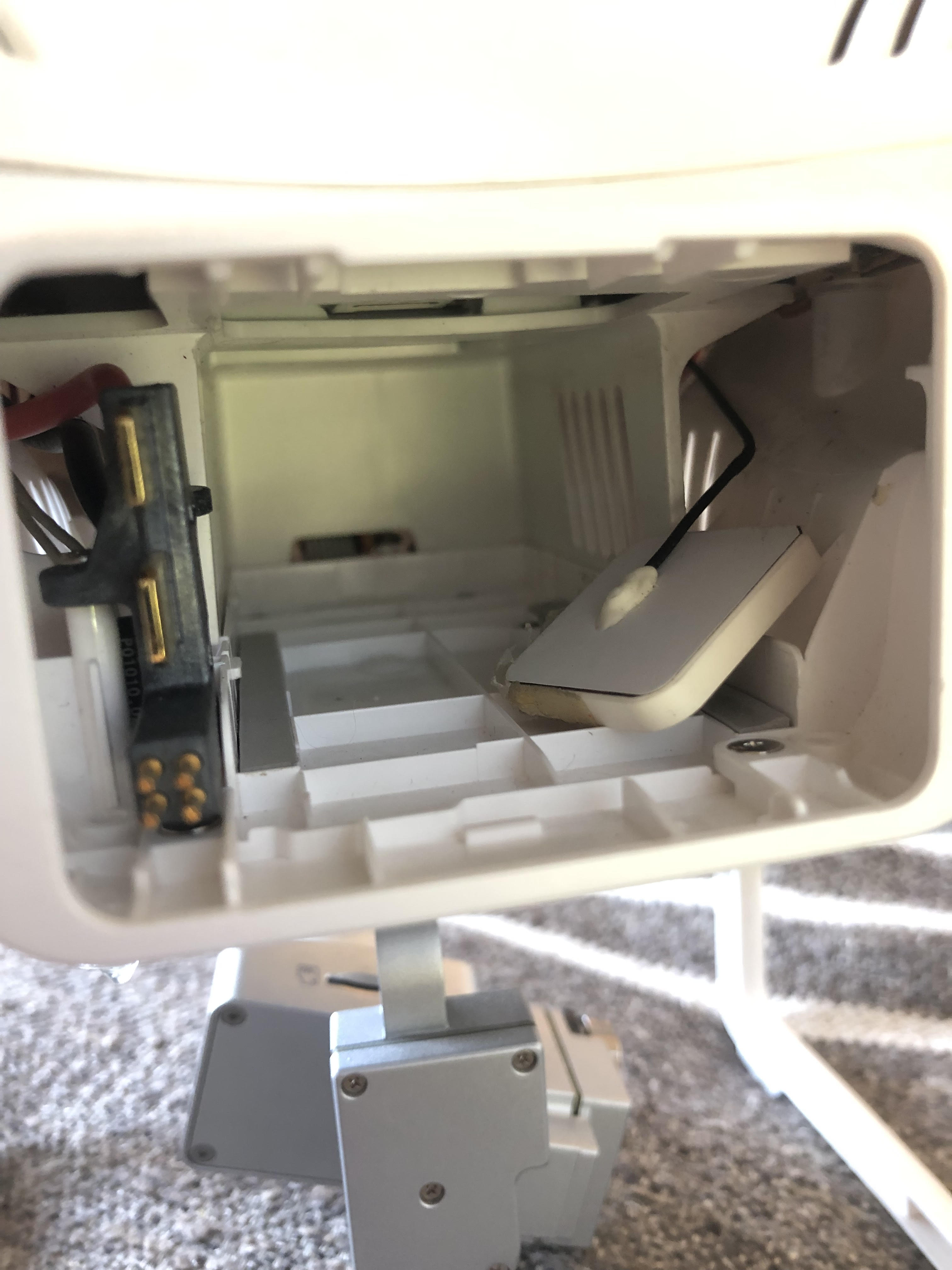

So I recently bought a used Phantom 3 Standard on Ebay and I noticed that a square component is loose in the battery compartment. The wire that goes into it is still intact. What is this component and is this a problem if it is lose? If it is a problem is it easy/cheap to fix?

Its 1 of the wifi recivers ,,one each side,,just hot glue back in,should see approx mark where it was,,if not hot glue, mayby velcro or strong double sided tape it been fine....I actually modified mine while back and had them outside the body,it helped with my lack of signal issue

No being loose wont make drone unstable but it could snap wire if movements are very sudden, and rattle,,,sounds like compass needs doin.
