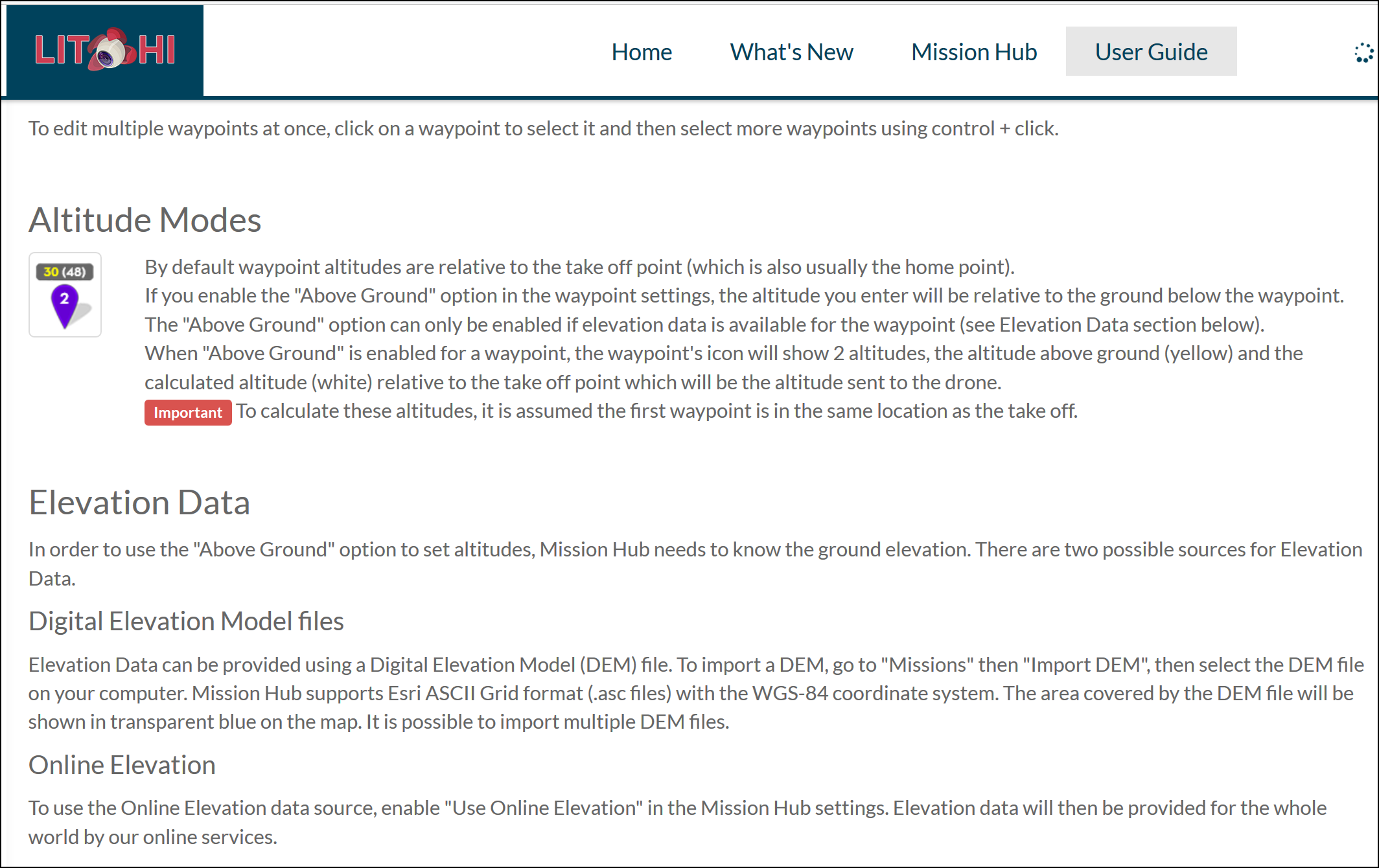

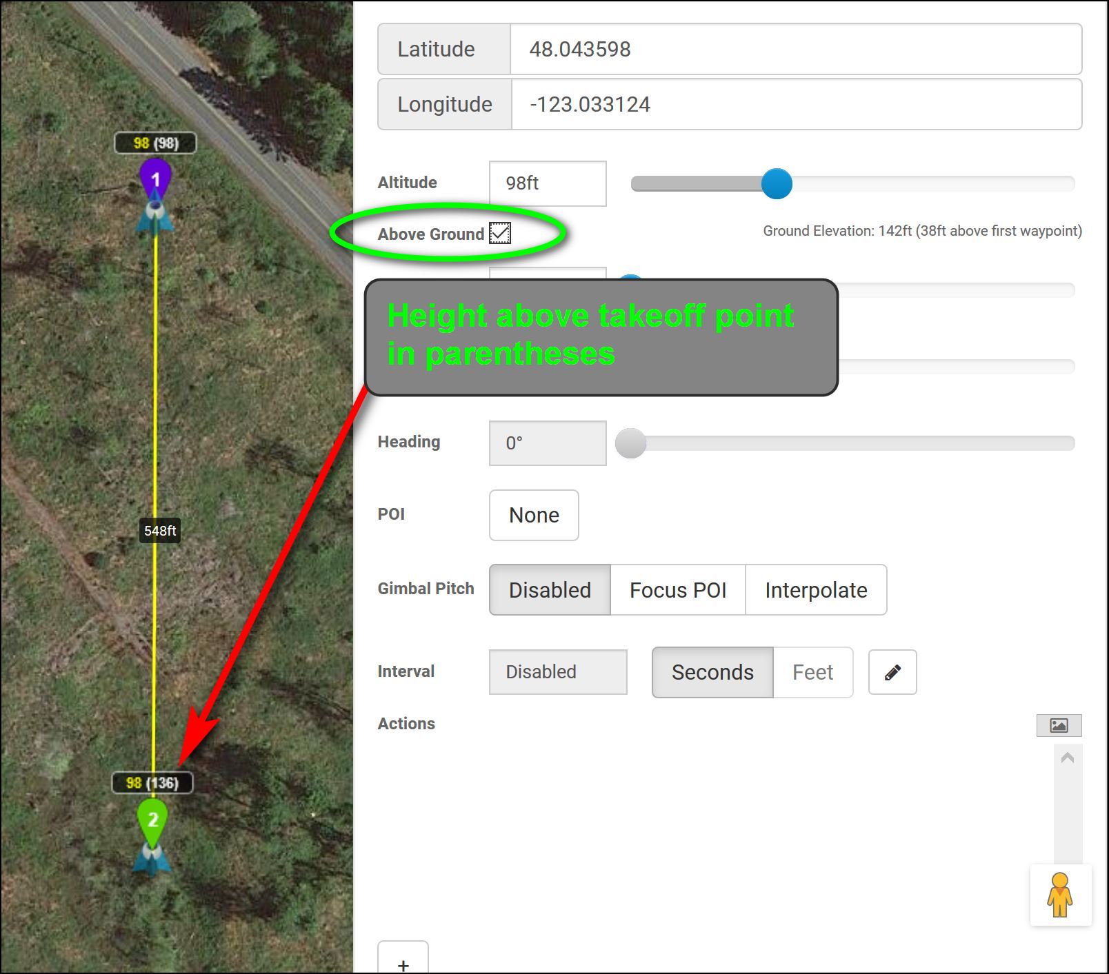

And, you have the option to use "Above Ground" for your waypoints in which case Litchi will check a data base for the elevation (msl) at the point of the waypoint and add your assigned altitude to that. It will not account for any grading since the database was created nor will it account for vegetation or man made structures.
I would add my usual caveat about “above ground” for info. May seem obvious but...
Litchi calculates above ground at waypoints only. Not continuously along the path. So if, for example, there is a big bump in terrain between waypoints, the aircraft will not adjust height. So if the terrain is variable like that, be sure to add enough waypoints to “sample” enough terrain.
