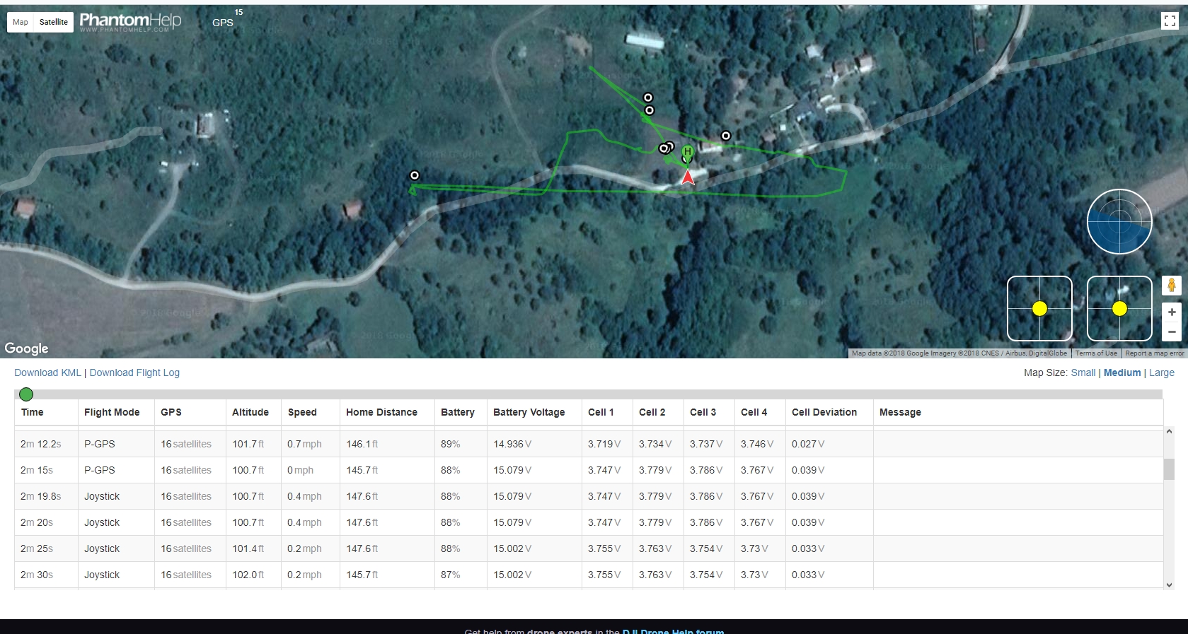

So I have done some research on this, and as far as I can tell, there is a big issue with Litchi when you use Pano mode, it drops the drone out of GPS mode and into 'Joystick' which causes it to drift off, sometimes quite far. Does anyone have any solutions for this issue at this point? I've done a few panos which I had to cancel mid-shoot due to the drone heading straight into a tree, and a few that haven't worked perfectly (see below).
As far as I can tell, too, 'Joystick' mode essentially means 'drift' mode, as any inputs I give on the right stick do nothing... I wouldnt even mind if i had to make microadjustments myself while it takes all the shots, but it just seems wierd that Pano mode has to switch out of GPS... Figured I'd ask here first before emailing Litchi.
