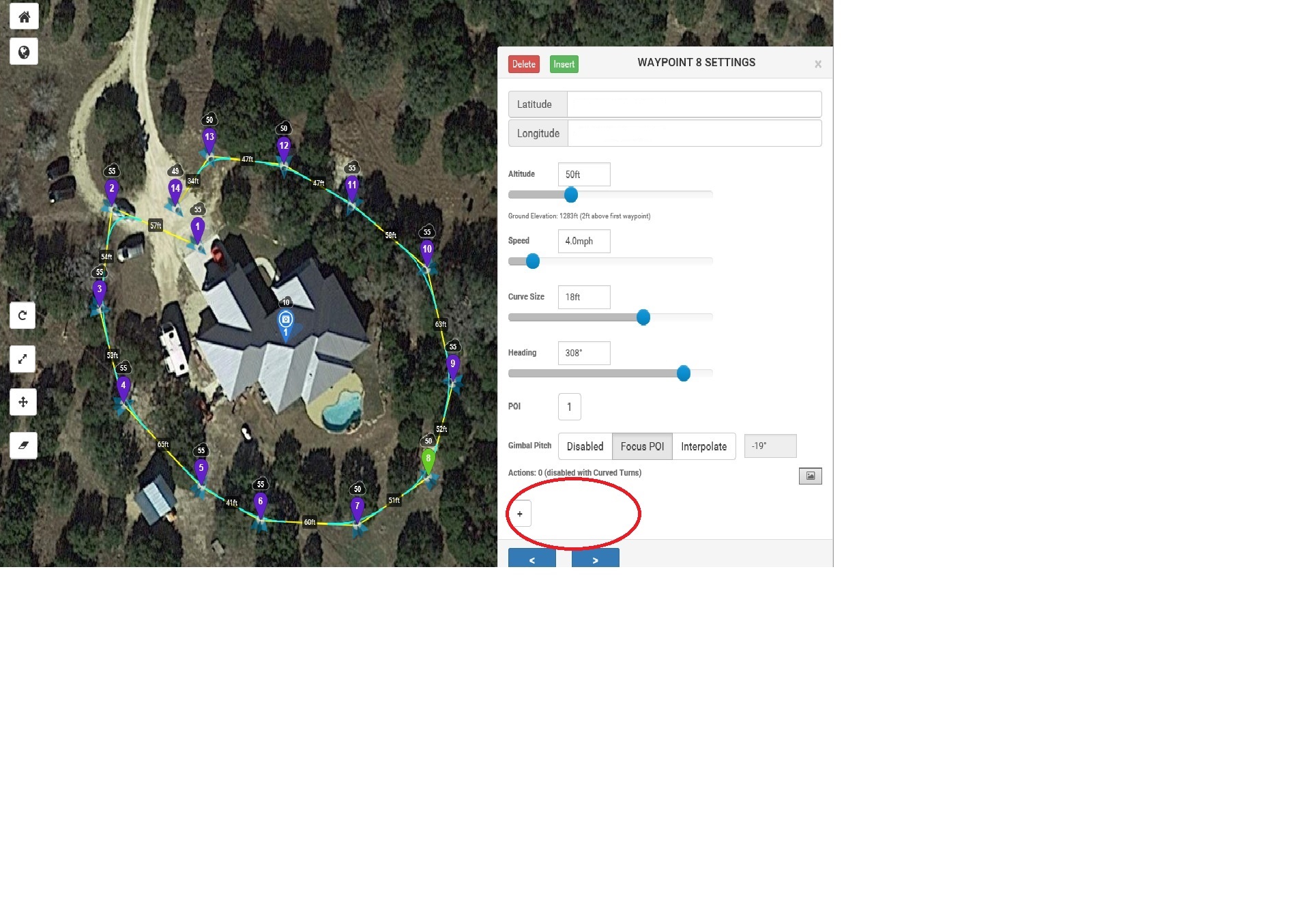

I didn't want it to stop. Just video as it flew around the house. What the camera is focusing on is the objective.
According to litchi, any information such as "Focus POI" and "Interpolate" provided to a waypoint that has a curve gets missed because the aircraft never makes the waypoint, its away from it with the radius.
Correct! You can set the height of that POI.
Now I have a P3S so no "obstacle avoidance". That's why I have to take my time and set up a mission very carefully. Some times if I can I will fly it several time to make sure I'm where I need to be then make my final video flight.
