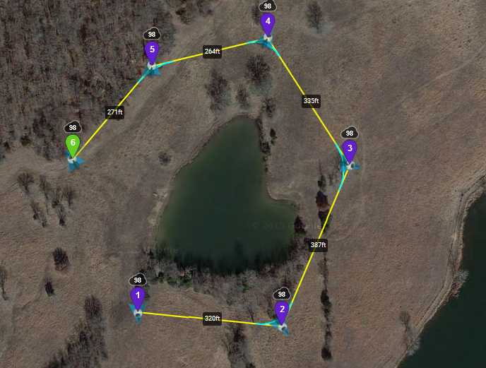

you can rotate the aircraft in litchi actions. when you program , just make sure the heading is facing the way you want and it will also face that direction and to the heading direction the next waypoint see how all of the arrows point outward?
