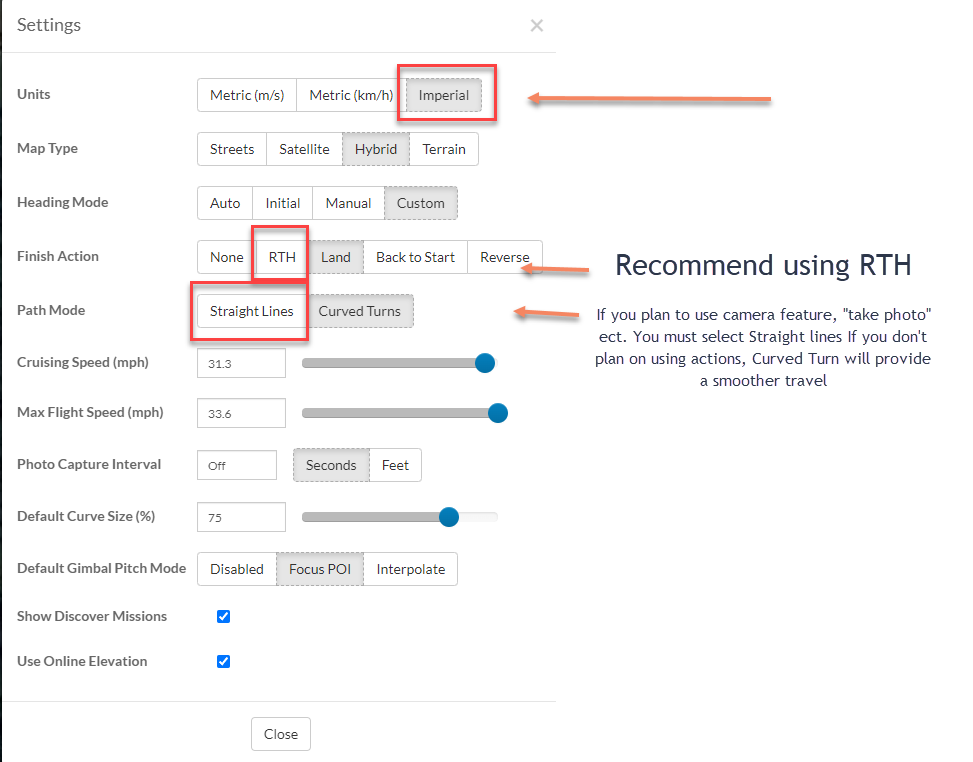

Here is a little more help for y'all

Thanks man I got it!!
